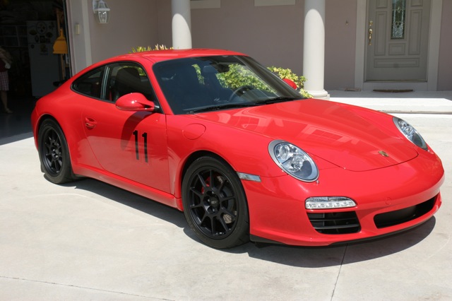

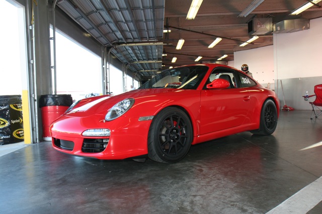

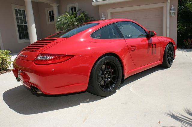

Not the greatest looking wheels but these are my track wheels 9x18 and 12x18 Forged CCW. You can see the sidewall has a little more beef to it. The tires in thes pics are Toyo R888 245-40-18 front and 305-35-18 rear and are right at the same diameter as the stock 19" with the skinny sidewalls.
