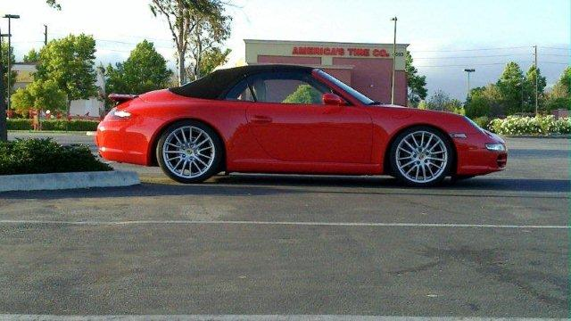

The Lights Self-Level Not Self-Adjust. Yes I raised My Adjustment Slightly After I lowered My car. MY beam Pattern Was aiming lower After I Dropped the car.
File Type: bmp
