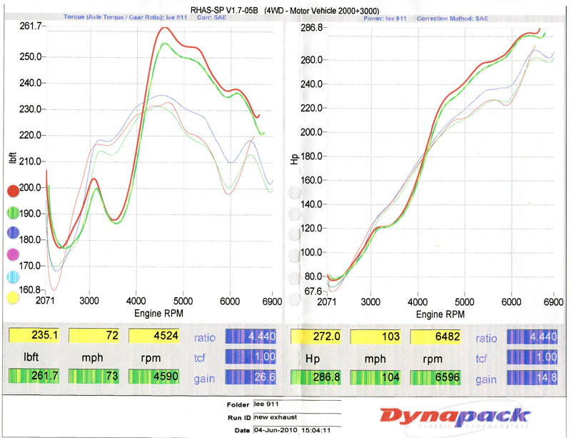

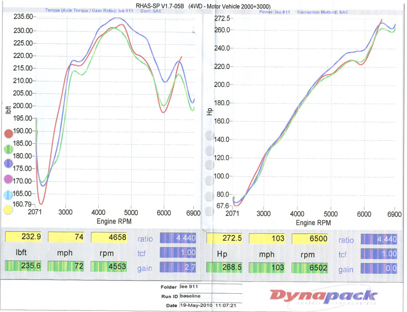

OK, I have completed the entire exhaust upgrade and did a dyno after each step to see the effects of the upgrade. First was getting a base (stock) dyno. 272 HP and 263 lbft torque at the wheel.
Next was installing a complete custom exhaust with hi flow cats, custom made X-pipe, resonator and hi flow muffler. did a dyno after this mod to record the results. Got 15 HP gain and 26 lbft torque gain. Unfortunately lost a bunch of torque a bit of HP between 3000 and 4100 RPM as shown on dyno chart.

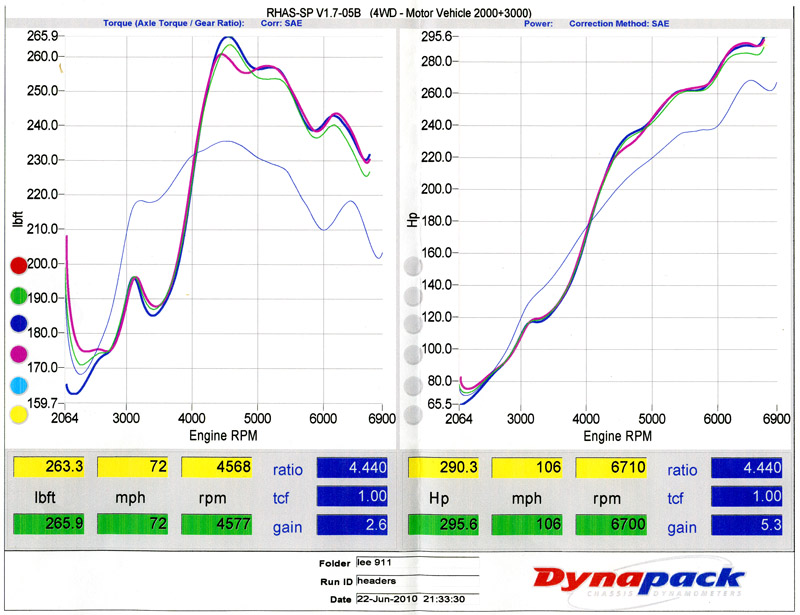

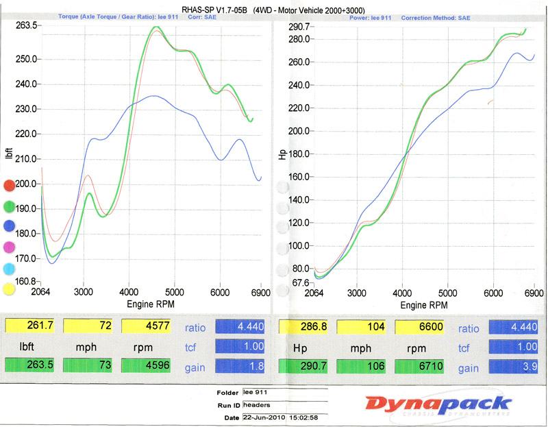

Final exhaust upgrade was new headers. This added additional 4 HP and 2.5 lbft of torque. Lost more torque below 3500 RPM but made ever slight gains after that until it peaks at 4600 RPM. See dyno chart.
All mods have been on the exhaust side up to now. Getting EVOM intake air system put in tomorrow and will have a dyno done afterwards to see the effects of feeding it more air if the EVOM air intake system does what it advertises. Will post the results tomorrow evening.

OK, Got the EVOM Intake system installed and here are the Dyno results. Gained another 5 HP at the top end and 3 lbft but it didn't change my curves at all. I'm now up to 295 peak HP and 266 peak torque.
