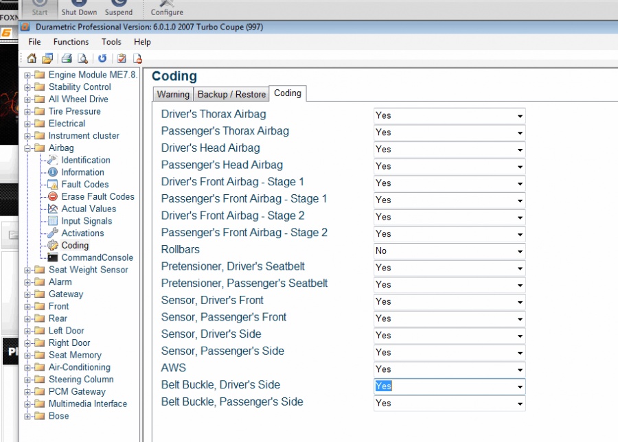

This is what they say on their website:
"Command console (professional version only). Provides direct communication with the control module for advanced users."
It is also described the same way in their manual and no further details. To a computer person, a command console is like a terminal so I am assuming I can bypass the limitations of the UI to get direct access to the modules.
Since they are so vague, I figure I ask people that actually own the product hence the post.
Old Dec 18, 2010 | 09:25 PM
jimny's Avatar
Joined: Nov 2009
Posts: 120
From: New York
jimny is infamous around these parts
Here it is on the menu. Look at the picture I attached. On the left side right below coding is "command console", have you ever click on it?
