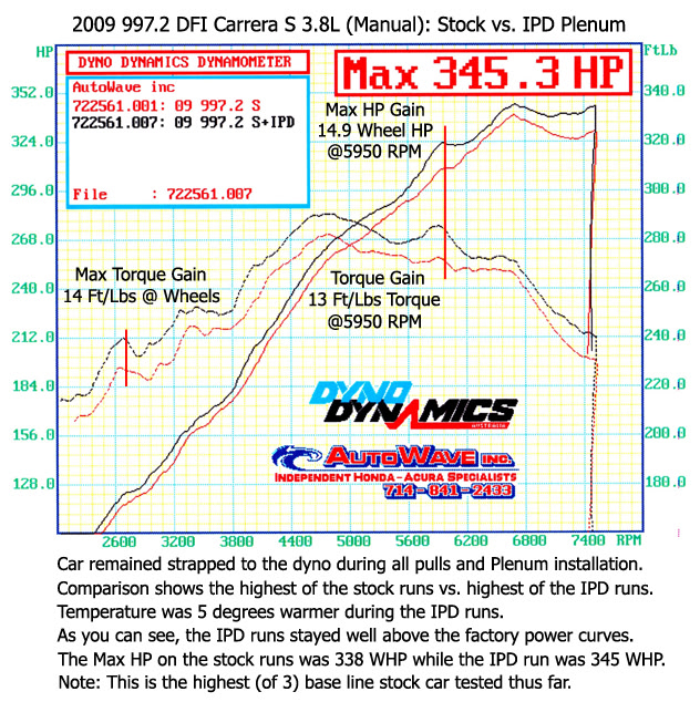

Here's the first 997.2 DFI Plenum Dyno Test
As you can see, the gains were even more impressive with our first test car. Max gains were even higher beyond 6850 RPM (another 1/2 of HP) but we don't typically count that area of the power curve when quoting performance gains.
We even have another bone stock car coming in tomorrow as well as a slightly mooded 997.2 on Friday. There's just no substitute for dyno testing.
That being said, We must politely say that this "Special Offer" is now closed. Thanks again to everyone for all their interest, consideration and enthusiasm.
Of course more dynos will be coming soon.

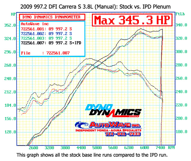

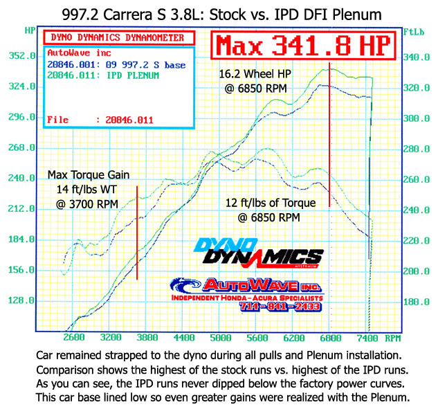

A Third 997.2 DFI Plenum Test
Greetings again 6 Speeders,
Well after all this relentless dyno testing we are not only exhausted but also pleased to announce that we are 3 for 3 on the DFI Plenum dyno tests, with the last test car delivering the most impressive gains and best results. IPD would once again like to extend our sincere gratitude to all the 6 Speed members who inspired this blind volunteer test offer.
As always, IPD is continually striving to develop the best after-market Porsche parts that deliver the best Porsche performance on the market. Although we extensively test all of our Plenums before they are released to the public, it always great to pass the “Public Challenge”.
This is the same Plenum, tested on the same dyno, tested on 3 different days, tested on 3 different 997.2 Carrera “S” cars with 3 different customers. All 3 volunteers were unknown to us before their testing day and they all came from right here on 6 Speed. All 3 customers were present at each of the test sessions and all 3 customers left with expectations exceeded.
Thanks again to all who volunteered and participated in this special IPD offer. We look forward to bringing even more dyno test sessions to the 6 Speed community in the future.
