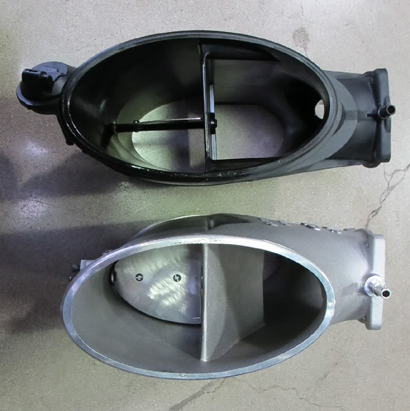

IPD DFI Plenum Installation
Greetings 997.2 viewers,
We are definitely trying to discourage DIY customers from attempting the install of any DFI application. It's difficult for us to gauge each customer technical aptitude and mechanical inclination so we play it safe and advise that all installs be performed by a trained Porsche technician who is familiar with Porsche engines.
Like all other IPD Plenum installs, the DFI Plenum is an R & R (Remove and Reinstall) procedure. Although the DFI install is still considerably easier than any of the Turbo applications there are still a couple of hurdles that make it less than user friendly for DIY customers.
Removing the factory intake is simple enough but getting the IPD Plenum properly positioned and seated into the rubber oval boots that connect the Plenum to the factory manifold can be challenging at best.
Removal of the factory actuator from the factory intake is easy enough but removing it without breaking requires a firm but controlled hand. Getting the hoses and lines disconnected and re-connected is relatively strait forward, especially is you are familiar with Porsche’s “Squeeze Pull” style connectors.
We do have an “official” installation guide for the DIY customers who welcome a challenge and prefer wrenching in the garage over hanging out in the Porsche service department. So if you’re on the fence about whether to install the DFI IPD Plenum yourself or send it to you local dealer or Porsche tuning shop you may want to contact us for the installation guide and compare mechanical aptitude tests with your fellow 6 Speeders.
Thanks again to 911 Molar for his contributions. It was a pleasure helping you through the process and I’m glad you share the same customer satisfaction as all the other IPD DFI Plenum customers. Thank you to everyone else for all the interest and consideration.
We should finally have DFI Plenums back in stock by the end of this week.
Cheers,
IPD Greg

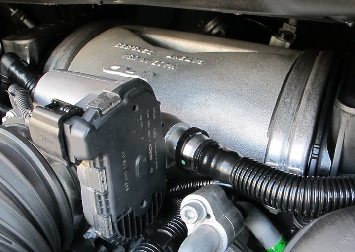

Please send me any tips or guide on installing your IDP plenum on my 2015 Porsche Carrera 4 991?
I've done supercharger system and turbos on other cars so I'm well aware of proper sealing. I remember using electrical contact cleaner to check the seal tightness after install. The 991 is blind on the back side so looks like it will need a mirror check on the seal placement.
*Any steps or guides from your experience that would make this more likely successful would be appriciated.
I've not found much DIY installs documented except for this discussion.
*One other question is why is the long bolt included in the kit called "A/c Replacement Bracket Bolt"? Is there some clearance issue?
Hopefully there a a little change of heart here on providing DIY installer instruction or tips to reach success.
Thanks!
Old Jan 21, 2017 | 04:55 PM
  #69
Dan911C4's Avatar
Joined: Aug 2016
Posts: 17
Dan911C4 is infamous around these parts
Trouble Report
Looks like I have the wrong IPD plenum for my 2015 3,4L 991 C4 PDK.
The part number was IPD Plenum DFI Porsche Carrera 991 3.4L 91482-3.4
There is no flapper valve or control assembly on the stock plenum. See image
Any recommendation? or should I return it? Thanks for any advice!
I bought the IPD off Amazon to save a couple of bucks. Maybe Porsche has a couple of different plenum configurations or my kit is missing flapper controls.
The plenum removal is easy after getting the car back side half apart. release the clamps and wires, and Lub up the seal with WD-40, let it soak, and pull up and back and the plenum pops out. I was being careful because I expected the flapper control lines to get tight. When it fell in my hands so easy I knew something was wrong.
Sent issue reports to both Amazon and IPD too.

Sorry, this was the best discussion area I found on the IPD plenum DIY install. The 997 and 991 and the same from the install prospective.
Update is IPD did quickly respond to the issue and will be sending me the correct plenum for the N/A 3.4L. I was very glad they make one for this engine.
My purchase decision was based on that I've done sub sonic velocity air mass flow modeling and design for piping systems. The features of the IPD design will increase volumetric air flow efficency into the cylinders feed tubes. Plenum has less turbulence with the flow diverter and dimples reduce boundary friction which can be quantified by fluid mechanics analysis.
Old Jan 28, 2017 | 11:40 PM
  #72
Dan911C4's Avatar
Joined: Aug 2016
Posts: 17
Update
IPD did a quick turn around on getting the plenum for the N/A 991 3.4 liter.
The delta is the S plenum has the internal flapper valve and N/A plenum does not. Lot of WD-40 on the seals and the stock plenum pops out.
Because the 991 engine is 2.5 inches forward than the 997, the engine needs dropped down 2 inches to get the bolt out. The bolt is very long and hits the underside of the body cross member. I added a couple of images in the video.
Change is due that the high socket head bolt to hits so they send a lower hex head to clear the plenum.
