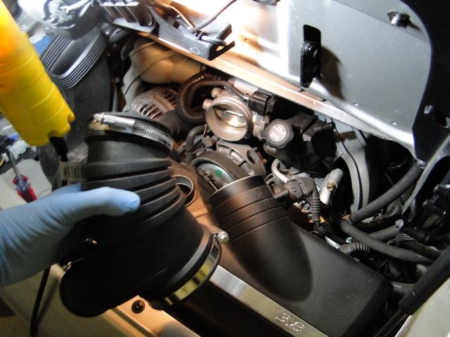

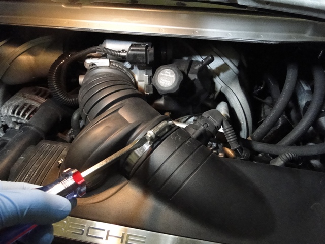

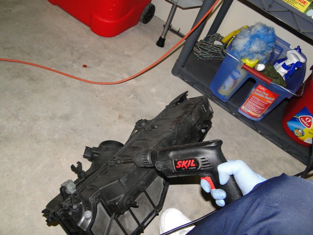

Air filter Change 997
I followed the above instructions and the job took about 15 minutes.
"Thanks guys"
A couple of pic's
15k miles and my old filter was toast.
(New filter on the left, old on the right)
and
Nope I dont drive down dirt roads.
* It seems like the car runs and sounds a bit better.

Removing the air intake channel on the left side of the engine
