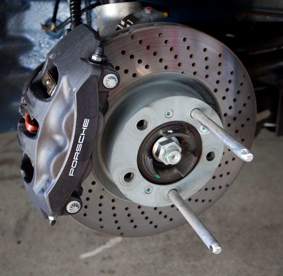

Just for the sake of completeness, here is a pic I found of 997.2 non-S calipers. It does indeed look like the pads cannot come back from the rear of the caliper so you will have to remove them. I have an "S" 997.2 and I never thought that was one of the differences...
If you do that, do not forget to hang them properly with a piece of wire (don't just let them hang by the lines) after taking them off. I may be mistaken but I also believe Porsche recommends not reusing caliper bolts.
If you are looking for a DIY, first look for one that shows how to change rotors as they generally explain how to remove the calipers safely. From there, it should be fairly simple to remove the pads by first removing the dampers with a putty knife and then sliding them out of the calipers. Put the track ones in - do not worry about dampers on those, there is no point. One last thing, do not forget to tie wrap the sensor cables behind the calipers so they do not dangle around, there are little pieces of copper wire at the end of the sensors that you might want to take out so they do not fall while rolling.

Just got done doing a pad swap and brake bleed on my 997.2 Carrera (Non S). Picture above is accurate in that you cannot swap out pads without removal of caliper and I add the below because there seems to be little youtube or other info available on the base model 997.2 pad/caliper diy.
My DIY (2009 Porsche 911 Carrera)-
There are three bolts on each corner that require removal.
1. Use a T55 to remove the two large caliper bolts. Porsche recommends these bolts be replaced with each removal (~$4 each).
2. Remove the 10mm bolt that attaches the brake line to the back of the caliper.
3. Hang the caliper with wire or string off the coil so not to put undo strain on the brake line.
3. Using a small flathead screwdriver, flip up the metal securing cover on the wear sensor and remove the connector that leads to the rotor. Use the same small flathead screwdriver to then move the wires free from the top of the caliper.
4. lift up the caliper away from the rotor.
5. *Note* - I found dealing with the wear sensors (there is one on each corner) the most difficult part of the diy pad job. If you simply yank them out, they will break. I also found using needle nose pliers next to impossible to remove them. If your goal is to re-use the old sensors as mine was, then I found that first pushing the pad facing you (outer pad) slightly away (towards removal off the two retaining posts) and then using a small flathead through the caliper under the sensor pushing upwards to pop it loose the most successful approach. Once the outer pad is free, then loosen the inner pad and pop off the inner pad sensor from inside the caliper.
6. Install wear sensor on inner pad and then press pad into caliper. Leave outer wear sensor free and press into place once inner pad is secured in caliper.
7. Press pads back into caliper with vice grips (cover up face of caliper to not scratch it!), tap onto rotor and reinstall three bolts. I used 63 ft lbs of torque on the two T55 bolts.
