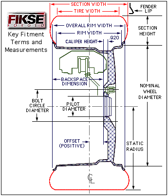

Wait a minute guys. You can't add offset by putting spacers on. Since offsets are negative numbers (the center of the wheel is inside the mounting face, not outside), adding spacers reduces the offset. i.e putting 7 mm spacers behind a 50mm offset wheel will result in an offset of 43mm, not 57mm.
Old Jan 7, 2011 | 12:17 PM
really? see 'offset (positive)' below. are those offsets we speak about, negative?
OK, my terminology may be incorrect, but the issue remains the same. Since the offset is apparently assumed to be positive, the addition of a spacer will still reduce that offset. Visualize the spacer in your diagram, which will push the wheel to the right, and thus move the center line to the right, thus reducing the distance to the hub face. So a 50mm offset will decrease to 43mm if a 7mm spacer is added.
you`ve succesfully confused me, so, no clue, let`s have Damon explain it to us.
OK, glad you brought this up. I was trying to think it through and could not come up with a way to make my 45 offsets into a 67 (for example). Now it makes sense, albeit a bummer!
I'm not Damon, but to give an example that might help explain it: the stock factory wheel rear offset on a narrow body is 67mm, on a wide body the wheel's offsets are 51mm.
If you put wide body rears on a narrow body car they stick out beyond the fender (or much closer to the fender edge than the 67mm offset).
Lower offset number = wider stance (on the same car).
Spacers give a wider stance: spacers lower offset numbers.
It is confusing. The Fikse drawing does not help...
The proposed 18x11 with 45mm offset from the original question will stick outside the fender edge by over 15mm
