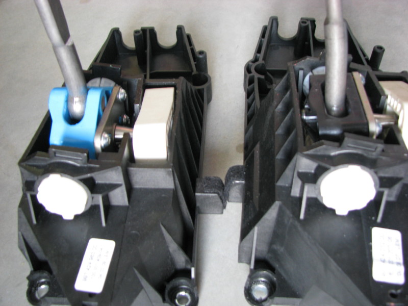

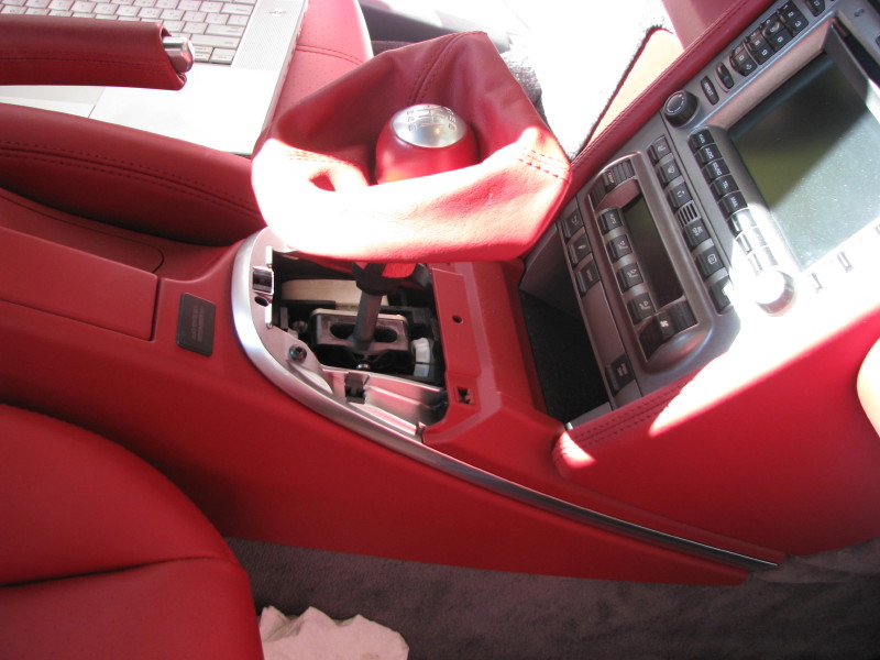

Here are some photos of the stock vs SS when I put mine in. They were almost identical looking, except the "pivot block" (for the lack of a better term) make the stick sit higher.Y ou can see this just by lifting up the boots (see photo).
