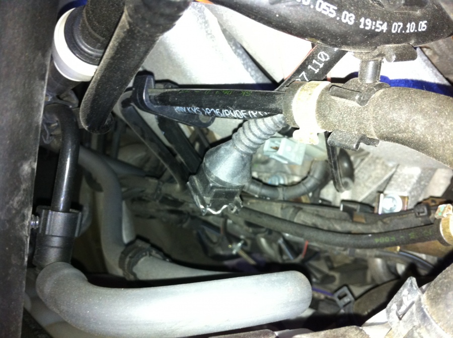

i just did this mod to my X51 the other day. The PSE can be disconnected behind the left intake snorkel. The connector is all black and sits 3-4 inches behind the left intake snorkel. Once you find it, its easy to disconnect.
here is a pic i took right next to the left snorkel, the wire disconnected is the PSE.

Help me in understanding if I am pointing to the right direction...
Here
Closer
And closer
Is that the right connector?

yup thats it, you just press in the metal clip towards the connector and the connector should pull apart easy.

the connector in the pic's you took is the PSE one, from my research the connector is normally found on the right side of the engine compartment and is balck and orange, except for X51's that are normally on the left. All i can say is the connector is on the left hand side on my car which is X51 from factory and the connector is all black. unplugg it and listen to amazingness!
