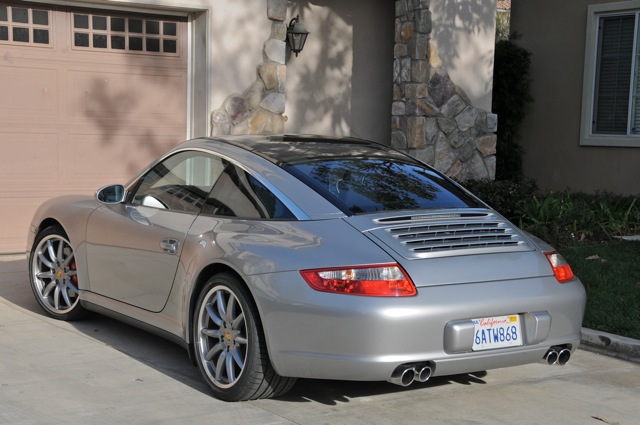

Siince you already have widebody wheels on the car, it won't have the factory spacers like mine did (mine had NB Carrera Sport wheels). Sounds like you don't need (or can't handle) much more wheel protrusion, so would agree that 5mm may be sufficient to meet your goal if you want a little more. I can't advise on any impact on required bolt length, but would assume you may need longer bolts.
Here is how mine looked.
