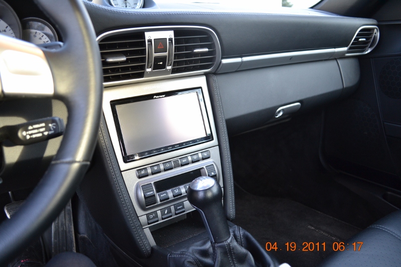

Mods completed:
  • Replace PCM with a Pioneer AVIC Z120BT and JL XD 600/6 amp;
  • Euro Motorspeed bezel kit;
  • Parrot dual mic;
  • License plate frame backup camera;
  • Clear side markers; and
  • Colour coded key hole plugs.
I replaced the PCM as a result of the cumlative high pricing for add ons for the PCM functionality I desired. All mods turned out excellent!
Dwayne at Custom Auto Electronics did an outstanding installation. It is crucial to find an installer that works on these cars. The only holes drilled were to mount the JL amp. He took out the Navi drive and placed the amp in the Navi compartment. All OEM electronics can be put back in with no drama, plug and play. The Bose speakers remained intact. Everything is clean and tight, as it relates to the installation.
As for the functionality of the electronics and the Chrono after the PCM is remove, set the options for lighting, wipers, locking etc. to what you desire prior to extraction. All functions will remain as elected. For the Chrono, it will remain functional by way of the steering colunm lever and dash display. All other Chrono functions will be gone. After the programing options are made, turn off the PCM and what you see is what you get. The new 2 DINs provided trip calcs etc..
Purchased the Parrot dual mic prior to install. The installer wired in the OEM mic, not good. Plugged in the Pioneer mic, not good. Mounted the Parrot mic to the steering colunm and plugged it in, great.
The integrated backup camera is great. The camera is hardly noticable, only a black dot on a chrome frame. Frames also come in black and the camera would disappear.
Next on the list is to install a Passport Qi45 with front LI laser jammers, then I will be done for now.
Again, thank you everyone for your contributions! They made the purchase and mod process drama free. I'm done for now...going for a drive.

Finally the weather has cooperated. Here are some pictures.
