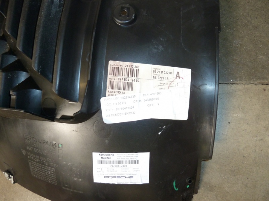

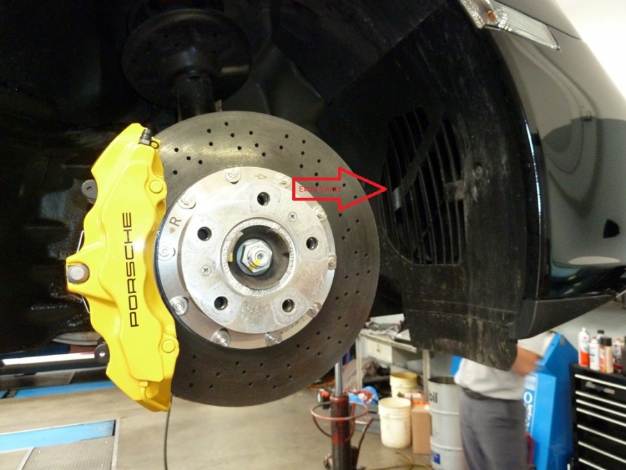

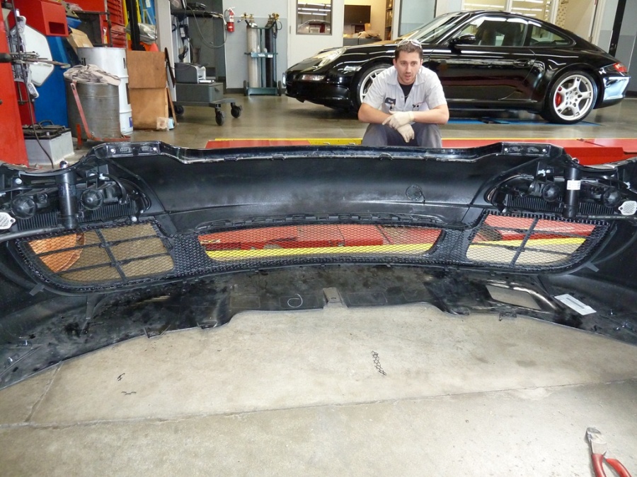

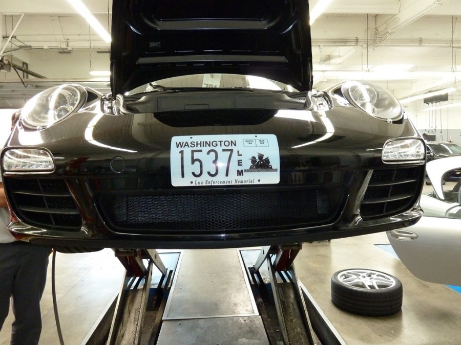

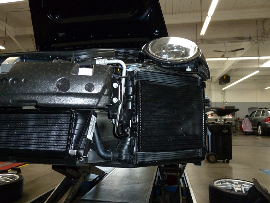

just an overdue note on the 3rd radiator and screens i put on my 2009 C2S / PDK.
the car was running hot at the track so i put on the rad and the "super hot country" ventilation from porsche. yes, that's what they call it. it's got more ventilation in the wheel well, some ducting, etc. you'll note also that i put a light coat of paint on the rads esp because the front one really showed up in the middle.
i got the screens from cargraphic after looking everywhere & thinking about the best materials to fab them from. for about $150, i got screens perfectly shaped, perfect material, etc.
i'll have to relocate my laser shifters from behind the screen but besides that, i'm really enjoying it.
the guys in the photos are sergey and wes from Barrier Motors in Bellevue. a bit of custom work there from them, hence the shout out. no affiliation.

Brendo is the Hot Country Kit a Porsche product or aftermarket? How much too?

Brendo, did you see how the bumper came off? Could you do it again yourself next time, if you needed?
as i recall, the radiator and ductwork was about $1400. the "kit" is really just the increased venting and i think the rad is separate. it's a silly designation. here's a pic below - may help you with the part numbers or i could shoot a mail to my parts guy. PM me if you like, mike.
on the bumper, it's pretty straighforward. the tricky part is these clips near the headlights that you need a small pick to pull out. and clamping the hose for the headlamp cleaner is a trick that the techs have. not a big deal but the clips.
