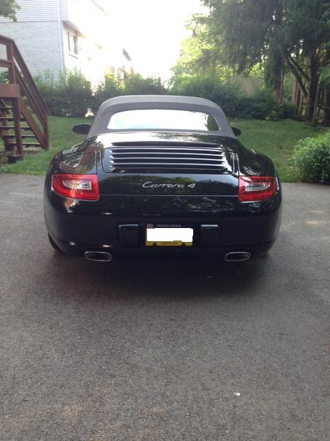

Conversion Update!
Originally Posted by myw
lets check out the conversion progress!
Just got the 997.2 rear bumper installed., the OEM LED taillights are pretty sweet! Glad I did the conversion when it's all said and done. I didn't realize the OEM turn signals blink Red, also running lights don't make a complete loop, just the brake light does, opposite of DEPO's (and opposite direction)., overall love the look of the lights and shape of the 997.2 bumper..Here are some photos, stock, Dectane/Depo, and OEM 997.2

looks lovely.... and the front end?
i have to admit that the overall 997.2 rear end does look better with 997.1 + dectane led 997.2 imitations (my current setup as well).
