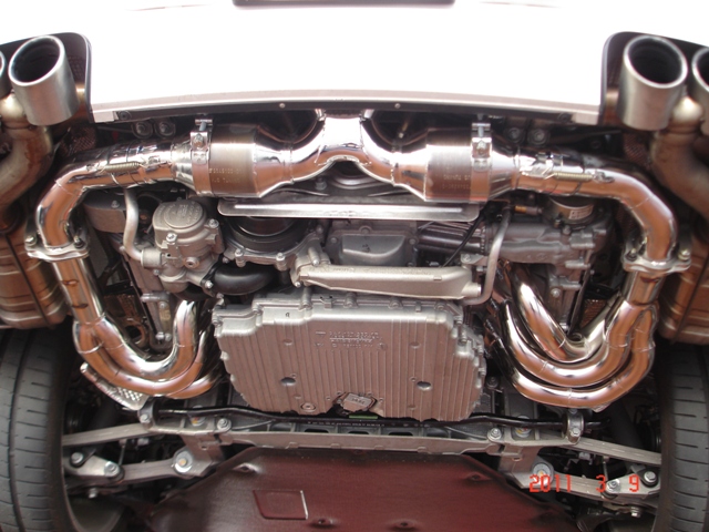

I have a 2011 911S w/PDK. In last March, I installed a FVD Header-Cat-System (Headers 70mm with200 Cell Cats), and flashload software. The result is very satisfying, I do feel a noticeable power gain over 5000RPM. No CEL issue.
In order to keep the total cost in control, I didn't replace the side mufflers. Because this FVD exhaust system comes with center muffler delete, the sound is loud at 5000rpm, I'm pleased with that.
FVD 997 100 61
Do you have C.E.L. without any flashload software?

Yes, you need use FVD software to flash loading the ECU to avoid the CEL. It's been over one year long, and I don't have any issue and my car runs great.
Yes, you avoid the CEL. It's been over one year great.
did you fit exhaust simultaneously flasloading Ecu or you flashload Ecu later?
Do you fit this exhaust with tri metal cats 200 cells HD ?

davidkuola is infamous around these parts
My exhaust is an old version, #BES 997 292 00S1, the vendor's fine note states that a software tuning is needed. I had the exhaust system installed first. Next step, prior to the software tuning, the FVD software was rewritten to adapt the exhaust system (and IPD intake plenum).

[QUOTE=davidkuola;3251029]I have a 2011 911S w/PDK. In last March, I installed a FVD Header-Cat-System (Headers 70mm with200 Cell Cats), and flashload software. The result is very satisfying, I do feel a noticeable power gain over 5000RPM. No CEL issue.
You fill more power gain only over 5000 rpm or you fill also more torque in the low/middle range ?is your 997.2 with PDK trasmission?
Is sound accetable for the urban use ?
thanks
My 2011 911S has PDK and sport chrono package. At normal driving mood, I don't feel too much of a power increase. If it's being set at sport, or sport plus mood, the car is tighten up and more powerful. However, you do need push it harder, over 5000 rpm to squeeze the extra power out. I don't feel to loose any lower end torque.
The FVD exhaust system has a feature of center muffler deletion, the sound is louder but not up to screaming and that suits me well. I don't know if it sounds better than Tubi, Cargraphic or other name brands.
Having had the hardware and software mods, I definitely feel the extra power/toque gain. For the money, I'm totally satisfied with the FVD built quality and performance. BTW, this is my six Porsche.
