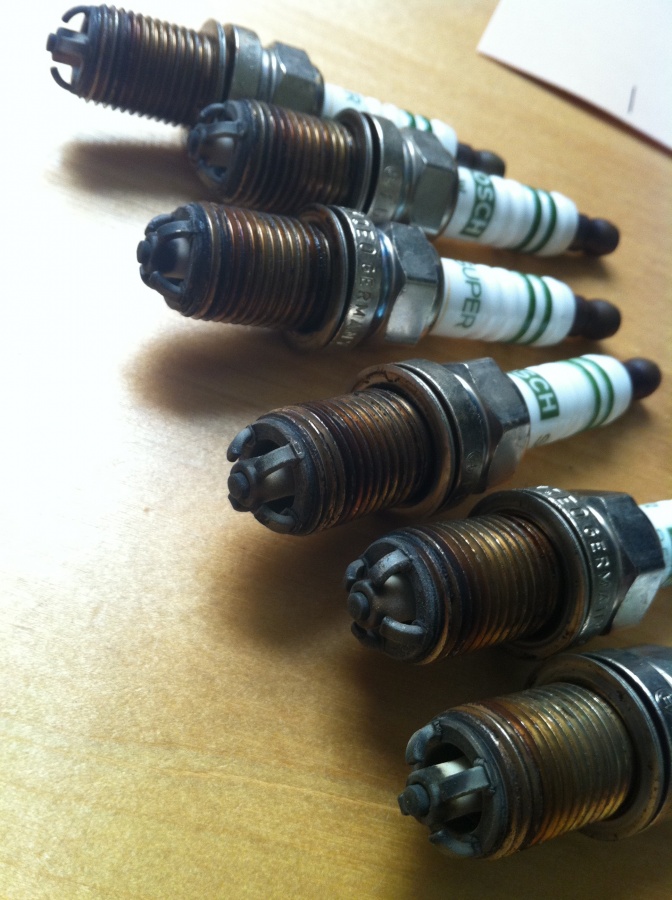

I had mine done @ the 4 year 22,000 mile mark. The dealer had a coupon special & I did not want them to freeze up & I had a taste of the freeze up on one plug on my '73 Targa. The plugs looked like a 2.5 on a scale of 1-5 (5 being the best). Afterwards the car ran like a champ & the idle was smooth.

Did mine at 5 yrs/9000 miles. They looked fine but still glad I did it. They came out easily.

I did have mine changed at the 4 year major maintenance (27K miles). Although they weren't toast, I'm glad I had them changed. Here are a couple of photos I took.
