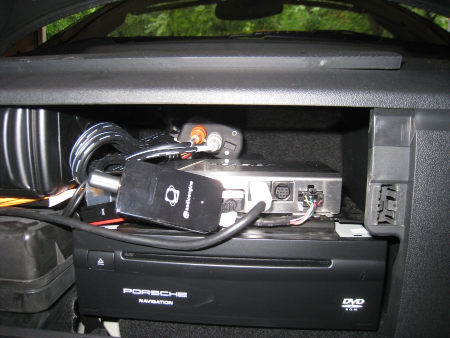

Hello,
I wanted to share a DIY wireless Ipod system I installed in my '05 C2S Cab. I had the Dension 500 installed yesterday (main unit and Aux unit installed on top of NAV drive). I had the cables run to the cabin for manual Ipod control because the interface via PCM is non-intuitive, time-consuming, and more dangerous, IMO ( tend to constantly change artists, songs, etc.).
Taking the install one step further, I then installed my AudioEngine W2 wireless Ipod system. This simply involved plugging the wireless receiver into the USB input and connecting it to the aux audio input via 3.5mm male to stereo RCA cable. I then connected the wireless transmitter to the Ipod via 30 pin connector.
This enables you to freely use the Ipod and place it anywhere you want without worrying about cable issues. It also makes for a nice, uncluttered looking cabin. Sound-wise, I can't detect a difference between it and the wired connection. The wireless system employed has higher resolution than bluetooth- the mfr. specs CD quality.
If anyone would like pics or more info, just let me know.

Wireless Dension
I had a local car audio company in Columbus, OH do the full install except for the wireless part, which literally took 30 seconds. I had them run an aux cable to the open area under PCM, and the Ipod cable to the glove box, which took them some time to do properly. The total bill for equipment and install was about $700.
I have attached 2 pics.
