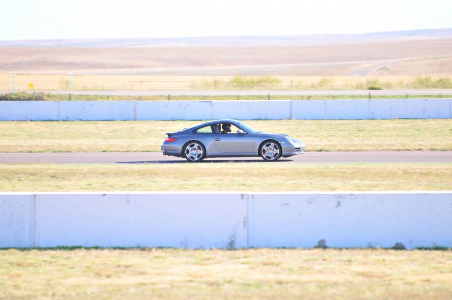

I need some help. I took my 09C2S to High Plains Raceway in Byers, CO, and now I am hooked. Only problem, getting to 131 mph, then braking to 90 just before turn 4 has proved to me that the standard "S" brakes on my car (same ones that were on a 996 turbo) are not going to be good enough. After 5-6 laps of trailbraking into the corners to set the car, noticable brake fade begins to occur. Not something I want to have happening at speeds over 130. Now I know track brakes are noisy, and they don't work as well at low temps (not DOT approved), but should I be switching to track brake pads?? Or should I change them each time (how hard is this?). And which ones do people prefer and why? My standard brakes were so affected anyway, that now when driving, a medium force "sweetspot howl" occurs. If I am going to have noise, may as well be with better brakes. Any thoughts?
