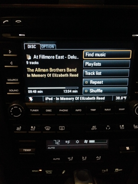

No blue light when I plug it into the Porsche, but i do get the blue lights when I plug it into a PC's USB port (using apple adapter). There is a firmware update but I can't update it because the software download at ViseeO's website requires a key code to unlock and I can't get a hold of anyone to get one. Terrible customer support for sure. If I get this working i'll post back, otherwise assume i've returned it.

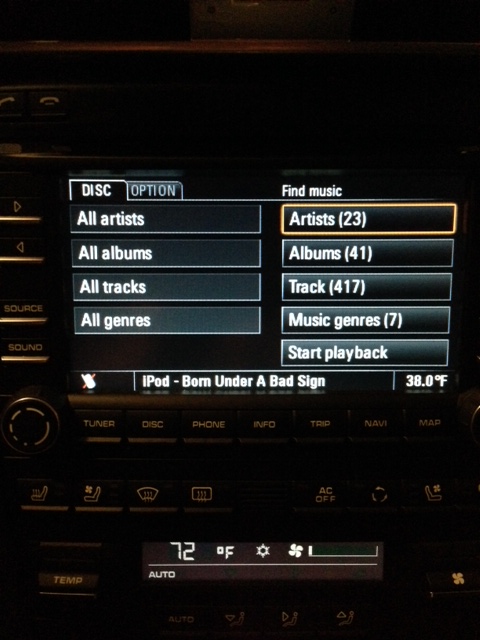

HA! Well im glad to report back that I got the damn thing to work! Googled PCM3 and WMA1000 and found a pic on Rennlist What I had no idea of was to plug the USB plug into the car, I figured that was for plugging in an android phone or other USB storage device. Also I didn't have the USB plug in there when I directly connected an ipod and the PCM manual said nothing (it's a lousy manual to be honest). So the damn thing works as well as MPM says it does. Full control of your iphone's music library and Pandora and probably other music apps as well just like it was plugged in directly. Nice toy

You can blame Apple for that confusion.
They had a 30 pin connector that provided both 5v DC charging (typically from a USB port on the other end), and 12v DC charging (typically from a firewire port on the other end, but hey, thats also what you get natively in cars).
Apple then went and along the way dropped using the 12v DC pins on the incoming connectors internally to the devices - so if the power delivery into the iDock cable came via the 12v DC pin exclusively - as it would in cars - then the device relying only on the 5v DC power pin gets zero power.
Thats why the Y shaped cable came about... to pull 5v DC from the USB port of the universal audio interface (UAI) and put power on that separate 5v DC pin as well as the 12v DC pin already powered. Now Apple's new devices with 30pin ports also get power... and any other device that also decided to power exclusively from the 5v sources.
Weakly designed and implemented standards always cause this sort of annoying nonsense.

I have the ViseeO and it works great, exactly the same as having the ipod plugged in on my 997.2.
Others have talked about needing the usb Y-connector to get it to work but mine works fine with just the old single connector cable that came with the 2009 997.
It does hiccup sometimes for less than a second but having the wireless capability FAR outweighs that.
By using the old single non-usb connector I am able to charge my phone if necessary from the usb port so the WMA1000 is simply awesome.
