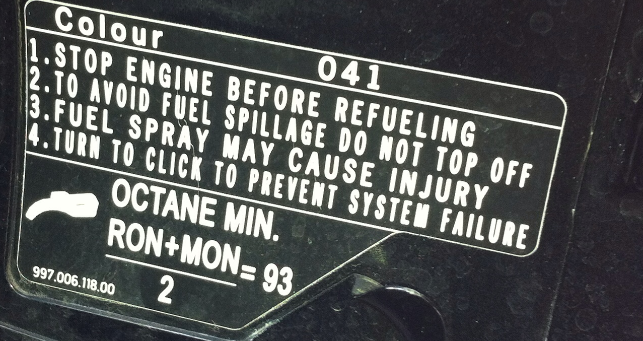

Cool Minimum Octane --> (Ron + Mon) / 2 = 93
I noticed that the minimum octane on my C2S is 93 based on (Ron + Mon) / 2 method. Most gas stations on my route have 91 octane only.
Does any pump sell 93 octane in the bay area?
King's Union 76 has 98 octane for $8.50/gallon and 104 octane for $9.40/gallon. They also have 100 octane and 110 octane, similarly priced.
975 Woodside Road, Redwood City, CA 94061, Phone650) 364-9620
Will 93 Octane improve performance compared to 91?
Do performance additives help? If so which?

From the manual:
Fuel Recommendations
Your Porsche is equipped with catalytic converters and must use UNLEADED FUEL ONLY.
Your engine is designed to provide optimum performance and fuel economy using unleaded premium fuel with an octane rating of 98 RON (93 CLC or AKI). Porsche therefore recommends the use of these fuels in your vehicle.
Porsche also recognizes that these fuels may
not always be available. Be assured that your vehicle will operate properly on unleaded premium fuels with octane numbers of at least 95 RON (90 CLC or AKI), since the engine’s “Electronic OctaneTM knock control” will adapt the ignition timing, if necessary.

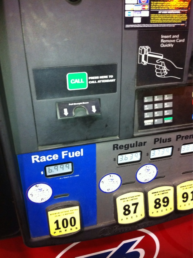

100 Octane under 7 bucks!
Just filled a tank full!
Let us know what you think.
I topped off with about 7 gal of 100 octane earlier today as well @ the 76 Station on Alamden Expy in San Jose.
Definately peppier over the hill back home.
Enjoy and HNY
UJ

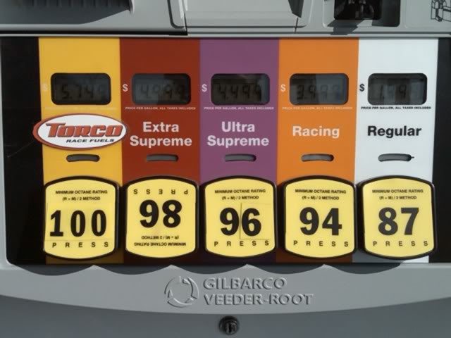

Found this list of high octane gas stations:
Bakersfield
Buttonwillow Raceway (road track)
located 28 miles northwest of Bakersfield off I-5)
Inyokern
Buttermilk Acres
VP Racing Gas Station
3565 W Inyokern Rd
Ridgecrest, Ca. 93555
Los Altos
VP Gas Station
Los Altos Rancho Shopping center
660 Fremont Ave
Los Altos, CA 94024
Los Banos
DB Corp 76
1963 Pacheco Blvd
Los Banos, Ca. 93635
Madera
Country Club 76
17017 Road 26
Madera, Ca 93638
Manteca
Frank's One Stop
2072 W. Yosemite
Manteca, Ca. 95337
McFarland
Famoso Raceway
33559 Famoso Rd.
Mc Farland, Ca. 93250
Modesto
Modesto Gas
1401 Coffee Road
Modesto, Ca. 95355
Patterson
Fred Frias 76
226 N. 2nd Street
Patterson, Ca 95363
Rancho Cordova
Valley Motorwerks
11401 White Rock Rd.
Rancho Cordova, Ca 95742
Rancho Cordova
Midnight Performance
3282 Luyung Dr
Rancho Cordova, Ca. 95742
Redwood City
Kings 76 Station
975 Woodside Road,
Redwood City, Ca. 94061-3610
Sacramento
Watt Tosco 76
2847 Watt Ave
Sacramento, Ca. 95821
Salinas
Laguna Seca Raceway
1021 Monterey-Salinas Highway
Salinas, CA 93908
San Jose
Damar Petroleum
1201 Almaden Expwy
San Jose, CA
San Jose
Goodies Speed Shop
345 Lincoln Avenue
San Jose, CA 95126
San Jose
Almaden Racing Fuel
76 Station at Almaden and Foxworthy
3010 Almaden Expressway
San Leandro
VP Gas Station
1495 Hays Street
San Leandro,CA 94577
Selma
Exxon Gas Tiger Mart VP Racing fuel behind main station
10610 E Mountain View Ave
Selma, Ca. 93662
Sonoma
Infineon Raceway
29355 Arnold Dr
Sonoma Ca. 95476
South San Francisco
Gotelli Speed Shop
321 El Camino Real, 94080
Stockton
VP Racing Gas
1033 W Charter Way
Stockton, Ca 95206
Sunol
Sunol Super Stop
3004 Andrade
Sunol, Ca 94586
Tracy
VP Racing Gasoline
2375 N Tracy Blvd
Tracy, CA, 95376
Turlock
Golden State 76
881 N. Golden State Blvd
Turlock, Ca. 95380
Waterford
JK Service
12405 Yosemite Blvd
Waterford, Ca 95386
here: http://www.audizine.com/forum/showth...n-the-Bay-Area.
Image from Sunol Super Stop, 3004 Andrade, Sunol, Ca 94586
