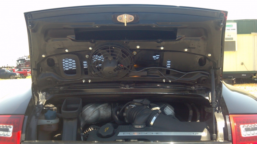

The "supplier" of the wing actually sends Porsche OEM mesh with it. I can only guess that they are from the GT3. Pics relevant.
I used silicone adhesive to attach the mesh to the underside of the wing. Good for up to 450C, so I'm assuming it will be just fine.
Also - prior to installing the mesh, I used a can of spray truck bed liner and "rattle-can" sprayed the inner surface of the wing to give it a more OEM look when open. Picture of underside of wing pending.

Equinox,
Did you just use straight adhesive on the tabs of those mesh grilles? No other fastener needed?
I had been thinking about putting mesh on my intake openings (Precision Porsche GT3 rep wing) but I got frustrated trying to mold mesh (from Home Depot) that would be good enough to fit. Now that there's OEM stuff (and thanks for providing the part numbers!) with smaller tabs - I figure maybe not so hard to do??

Yes all adhesive. I first spread adhesive onto the flat solid portions of the grill mesh, making sure to also cover the small fastener hole. This allowed me to see when the adhesive made good contact with the inside face of the wing, causing it to ooze back out the back of the hole. Once I allowed this to cure, I double checked the alignment on the other side of the wing to make sure I made it fit the best it would (it's not going to be perfect, but you can get damned close. I would recommend the best setup of having the wing upside down on a saw horse, allowing you to see both sides, and gravity to hold the screens in - otherwise you may use painters tape if the wing is already installed.
Once the glue has dried, and the mesh isn't moving, finish up by gluing all the way around the edge of the mesh, creating a "gasket" where wind and water can only go through the mesh, and not the sides. This also hides any gaps, if you have any, depending on manufacturer of the wing, and allows you to hide them with your black sealant.

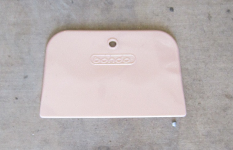

Tools:
Two spray bottles
Johnson and Johnson Baby wash
Sharp *** knife, fresh blade,
Bondo spreader for backing behind the cuts you do
Then follow this: http://www.clearbra-kits.com/install...tion_guide.asp
