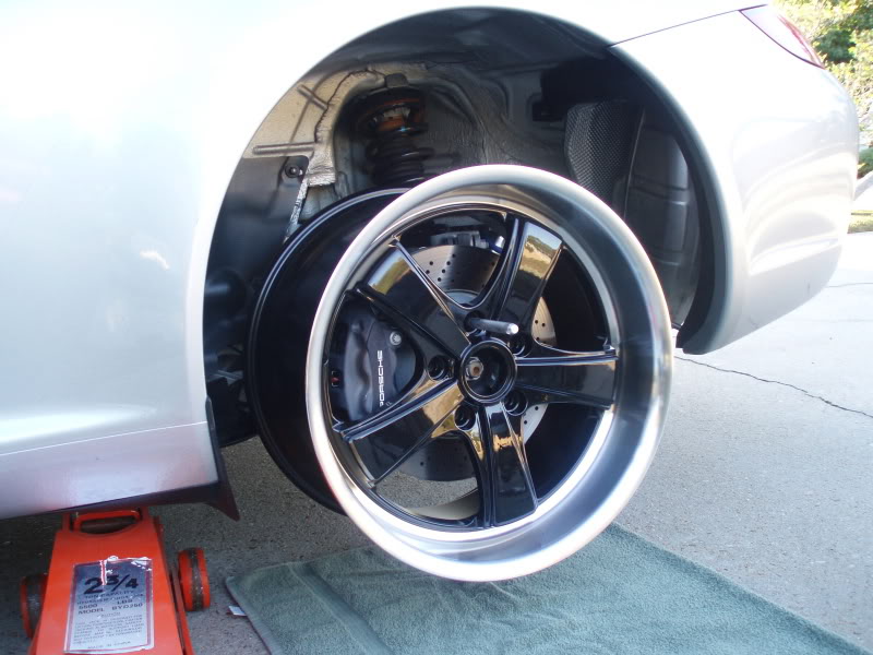

+1 on the pin available from Suncoast. I only have one, but I could see where having two might make the job even easier.
