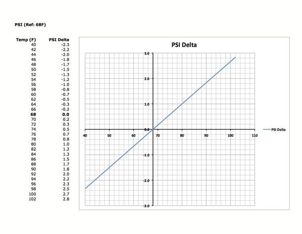

Switching to alternate tire configuration in tpms setup. Starting the learn process and switching back to actual tires and redoing the process will fix issues on 997.1. You may have to drive hwy speed in a straight line. 997.2 has better sensors and faster detection times.
As a side note:
Tire pressures are really important on cars with tight suspensions and lowered like the S.
Depending on temperature outside in shade close to ground (not road temperature) adjust pressure based on chart attached. Car should not have been driven more than a mile preferably. See link on how driving for a while heats air in tires.
Here is a good read.
http://www.tirerack.com/tires/tirete....jsp?techid=73
If you are technically inclined. (Hopefully it does not have contradicting info)
http://www.arden.org/misc/pressure.html
Here is why nitrogen lasts longer when used and does not react to temperature changes much.
http://www.popularmechanics.com/cars...stions/4302788
The Porsche manual also explains this but not in detail.
Hope this helps!
