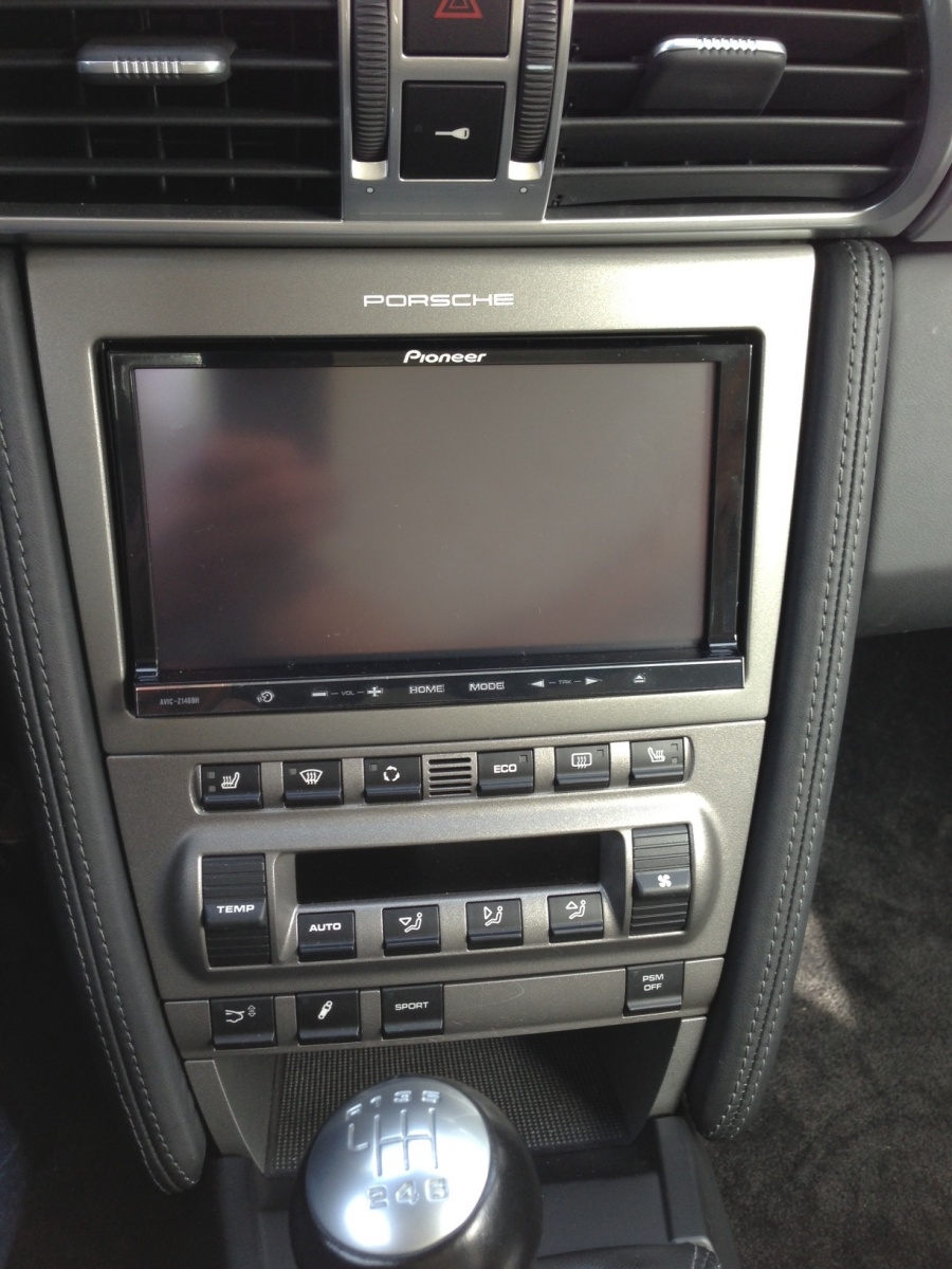

Avic-z140bh
I had installed a Pioneer AVIC-Z14BH in my 07 911S. The head unit powers the speakers and the original bose amp powers the sub. Sounds pretty good not outstanding, but the car is so noisy it really doesn't matter. Had a shop in Culver City, CA do the install. They have done other 6speed members cars and they work on a lot of porsches. The owner has 2 black 997s.
The voice activated dialing doesn't work well. You have to download your contacts from the phone and if any one of your contact names has any character besides a letter eg. #,&,-,@,. it will not work properly.
