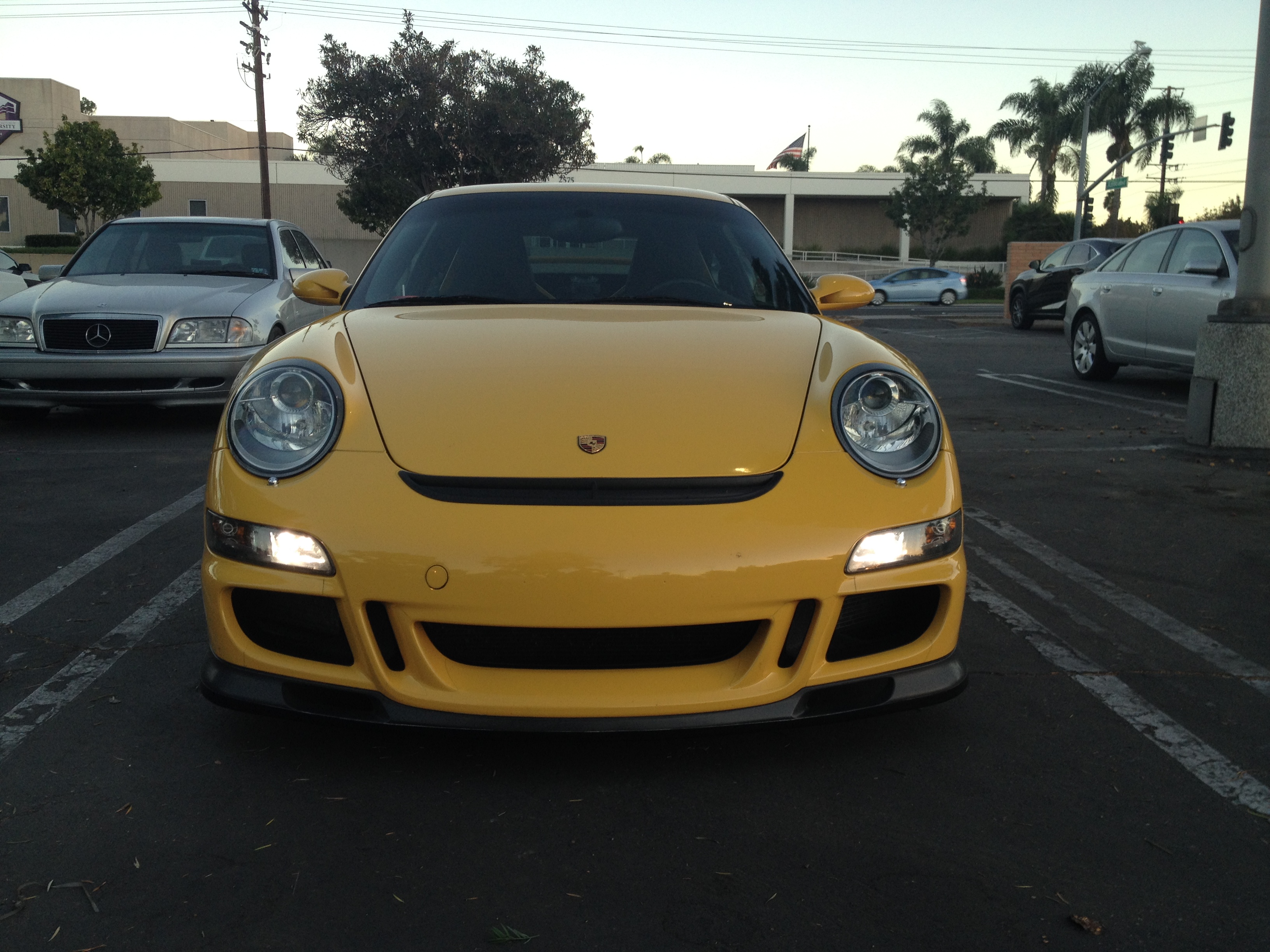

  #312
YellowDragon's Avatar
Joined: Oct 2007
Posts: 90
From: Palos Verdes/So Cal
YellowDragon is infamous around these parts
Originally Posted by YellowDragon
Thank you for such a detailed write up and photos. I had your post and pics printed out to assist me for this hack. It took me about 30 min but I was really taking my time to do this perfectly. The result is exactly as described and exactly what I always wanted - fog light only on as DLR and no other lights. Before I learn about this hack, I even checked with Durametrics and even they could not get it done via coding.
I usually leave the switch at 'OFF' not 'HOME' when in garage and hooked up to a battery maintainer. So far it's been a month since the hack with no battery issue.
Thanks again to PSPorsche and a BIG, BIG thank you to Utkinpol the OP for this hack. Not only you made my wish come true but also help me save lots of $$$.
Love the look of fogs as DRLs!
