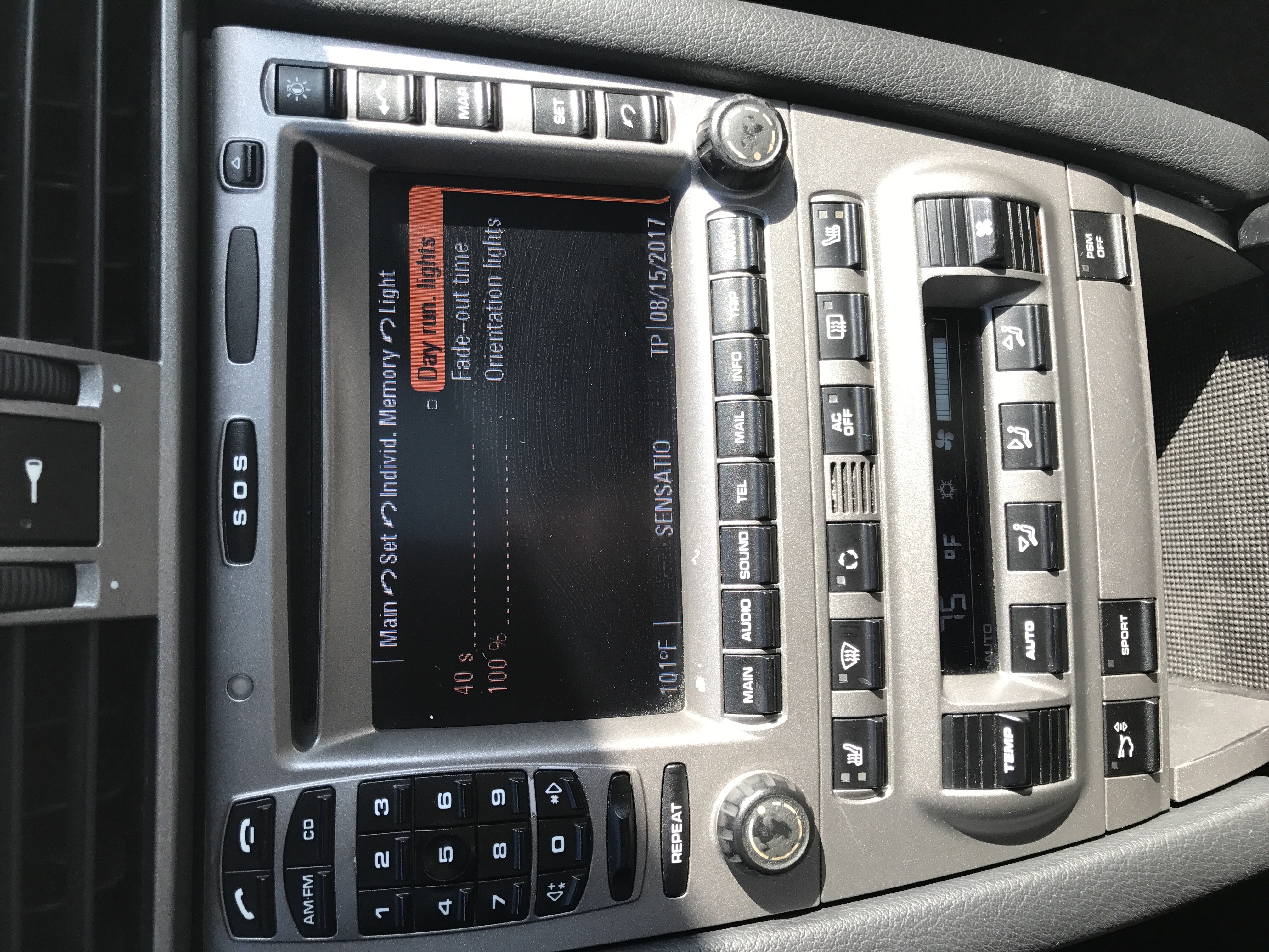

Yes you can have daytime running lights but set it though the PCM. I wouldn't mess with the switch for daytime lights to pass inspection.

Old Aug 15, 2017 | 04:38 PM
  #323
Petza914's Avatar
Joined: Apr 2012
Posts: 2,096
From: Clemson, SC
Rep Power: 135
Petza914 has a reputation beyond reputePetza914 has a reputation beyond reputePetza914 has a reputation beyond reputePetza914 has a reputation beyond reputePetza914 has a reputation beyond reputePetza914 has a reputation beyond reputePetza914 has a reputation beyond reputePetza914 has a reputation beyond reputePetza914 has a reputation beyond reputePetza914 has a reputation beyond reputePetza914 has a reputation beyond repute
On a .1 car that turns the headlights on all the time, not the aftermarket bumper LEDs and what this thread was all about. On a .2 car it uses the factory bumper LEDs, but then you don't need any sort of hack.
I understand what your saying, I have the led dialed hack and been running it for 2 years now with no issues. What I am trying to say is use the PCM to pass inspection then you can keep the switch with an option to turn it off.
Now I understand what you're saying too. That's a good idea.
Thanks - that's a great suggestion I hadn't considered. 😀
