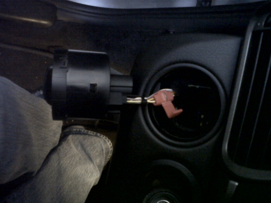

$2 DRL solution for fog lights
I finally got to a shop to buy wire taps.
so here is how you get it done - you get out your light switch and you tap together 'A2 - automatic light yellow/red' wire with 'A5 fog light yellow/white' wire.
now when you put light selector into 'home' position your front fogs will light up when engine is working. 'home' function also works as usual when you shut down engine and fogs turn off in 30sec after you exit the car.
works fine.

do you know the difference between the 997.1, and the 997.2 headlight switch? do you have access to the wiring diagram for the 997.2 like you got for the 997.1? i have been trying to have that function and bought the dectane module but i have a trickle charger on the car so that is not a good solution. i am not familiar with the home setting , what all does that do, just delay the lights shutting off for 30 sec? any help will be appreciated. could you run a hot wire from the ignition switch to the fogs? but then you could not turn them off with the car running. mike

you would need to find a diagram. then take voltmeter and check - when switch is not engaged both wires should have logical '1' which will be somewhat close to 11v.
when engaged it will be ground. 'home' wire goes directly to ground, fog light is more complicated - it gets to ground via relay driven by switchable power but works fine when connected directly to ground in my car too.
some signal wires have 0v and are engaged by logical '1' - so you need to make sure it is same. 997.2 has different engine ECU, i am not sure what it has for front ECU. may be same, may be not. to know for sure you need to find its wiring diagram.
'home' function is an odd thing - when you drive into garage and turn off motor it lights up fog lights so you (apparently) can see around in the garage, then in 30sec car turns fog lights off.

Originally Posted by utkinpol
I finally got to shop to buy wire taps.
so here is how you get it done - you get out your light switch and you tap together 'A2 - automaic light yellow/red' wire with 'A5 fog light yellow/white' wire.
works fine.
Very cool. So for times that you want less bling, you could turn the lights from 'home' to the 'off' position?

Post What about night time?
What happens when you switch the lights to the "on" possition?
Does eevrything else work as normal?
Good find -
Good find -
yes, as there is nothing done.
and yes, in 'off' position it is all off. all you do with this hack is to connect fog light signal to a ground like it does when you turn it on in a normal way. but this way other lights (side, rear) do not engage. just fogs.

You guys are not reading - fogs are turned by switch when it goes into 'home' position. In original 'off' position all lights are off.
With default fogs light switch position you first turn on side lights, then if you pull out switch it turns on fogs. With this hack I did you can turn on fog lights only, with side lights remaining off.

As of 997.2 question I looked at a catalog I have and it seems light switch part number is same. Get it out (press switch in and turn it a bit to lock then pull out) and compare color of wires on A2 and A5 pins.
