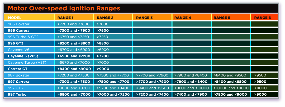

I think you should get a DME report first. If no over revs, then I agree with everyone. Go my09.

DME report needed if these are manuals. Probably not needed if these are tip or pdk.

as you can see, I am the very near future 991 owner, so excuse my lack of knowledge...what's the DME report ?

Originally Posted by modlin
both will be CPO by Porsche...
a report of over-revs usually cause by mishifting. it'll tell you the number of engine revolutions in each range how many hours were on the engine when it happened. its not a big deal in my opinion unless the report is really bad.

so as an example, for 911-997, range 6, such report would show how many times revs went above 9500 ?.....am I interpretting this right ?
thanks texas...
Right, you're interpreting it correctly. And yes, I meant ignitions. Do a search in the forum. There are a lot of example reports and peoples' opinions about them.
