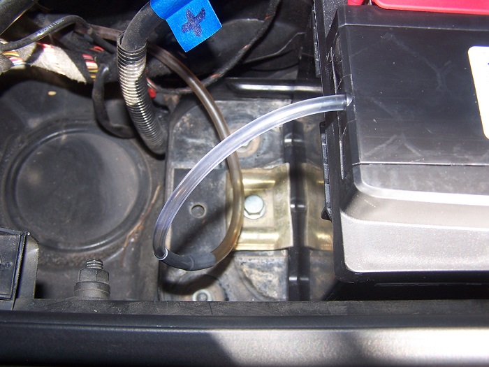

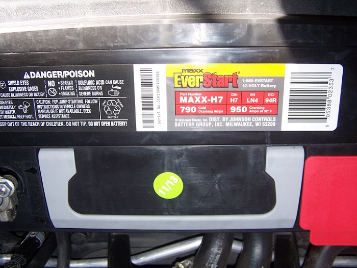

I bought a Wal-Mart H7 battery yesterday for $146.97. I discovered the car's vent tube is too large to fit into the vent port and I didn't have any adapters that would work properly. I took some fish tank tubing I had laying around from a previous project and figured out that it fits perfectly snug into the H7's vent port so I used a 2 inch sleeve of heat shrink to bond the two tubes together.
