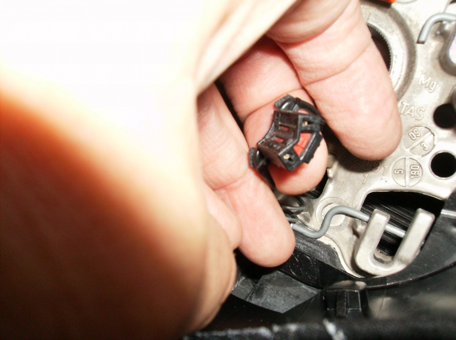

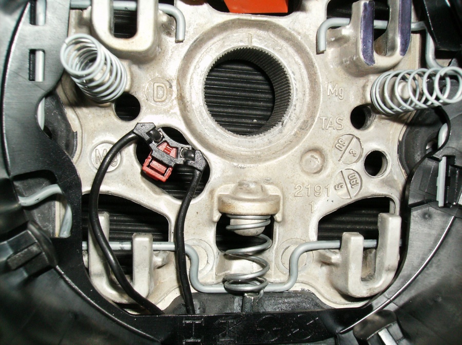

If a car did not come with a heated wheel, it doesnt have the wiring in the column to connect the wheel wires. The heating wire is a seperate part and unless they installed it when they did the wheel. It aint there.
If you buy a heated wheel from suncoast they will ask if you want the wiring kit also. You need to call and talk to ryan and give him the whole story.
First the mechanic has to take the wheel off and see that the plug is not plugged into anything. The plug on the heated wheel should plug into a socket on the column that has the 2 wire connectors in it. The mechanic put the plug into the socket. But there isnt any wire connectors going to the 12v source. Its just a blank socket.
Dont pay any attention to what the computer says yet. theres nothing to read.
heres a pic of a heated wheel connector and into the opening in the wheel. the socket on the column will have the socket sticking thru the opening.

Thanks OKB. Do you have a pic of the column side? I want to find out if the plug is a harness that plugs into the clockspring or is it part of the clockspring.
