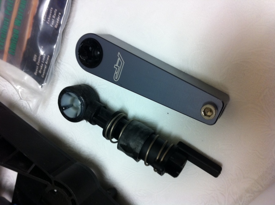

I got the AP soild linkage from Dan at Vividracing. Good piece of upgrade while installing the SSK. See the photos between the oem plastic piece and the AP soild piece. No problem during and after install. Easy to tighen with allen key if it get loose.
