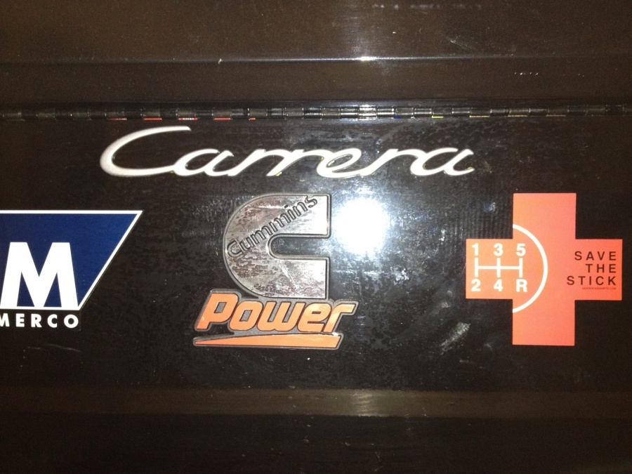

It's entirely possible if you are careful on removing your emblem and it was a cooperative emblem that didn't just bust to pieces....
Mine is successfully reattached to my toolbox....
