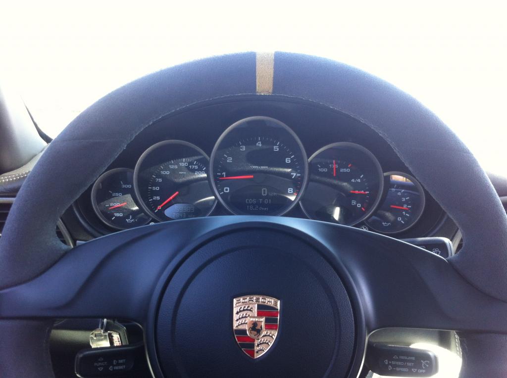

Originally Posted by AP1to911
first time posting my car up..
my 997.?
my 997.2 GT3RS airbag and wheel
it was worth every Penny!

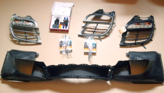

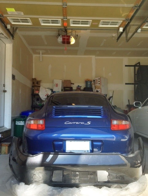

almost there!
picked up
- 997.2 grills (bought extra black one since one of my silver ones not in best condition... can have htem painted and 3m)
- 997.2 inner rad + centre shrouds (4 plastic pieces)
- 997.2 front oem LED's
- 997.2 rear bumper with parking sensor holes + brand new rear aftermarket parking sensors
- trazit bluHF for wireless audio access to my phone (music+phone calls)
- (unpictured) 3M film for 997.2 front bumper + 991 'P O R S C H E 911' badging.
still need
- 997.2 front bumper+lip
- 997.2 washer nozzles
- 997.2 rear clear leds - just found a set
- rear exhuast tip black bumper 'shrouds'
- rears i will likely use fvd converter and front led's i will likely wire up myself thanks to bill's help
ID:	396513   Click image for larger version
