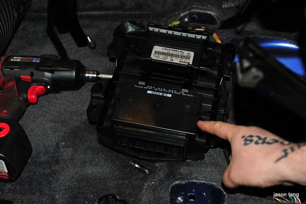

Originally Posted by lordhelemt
The dealer is telling me it's under the drivers seat. I guess i'll start there...
yes, it is under the driver's seat, under a cover that is mounted to the floor pan.
picture credit to Atomic80

No problem, just as a heads up, the cover is mounted with pinch tabs on the side closest to the rear seats. They are difficult to get to while the driver's seat is still in the car, but doable. Also, there isn't much play in the wires for the wiring harnesses, so be careful with any tugging/pulling while trying to remove the box containing the module

I personally didn't want to mess with the harnesses connected to the bottom of the seat, or worry about scratching any interior pieces trying to lift the seat out of the car. With enough light and an idea of how the cover is held in place, it really isn't too bad with the seat still in place. Obviously, the mounting bolts for the seats need to be removed, and the seat tilted back as far as possible.
With an extra set of hands to help lift the seat, it would be 10x easier to see what you are doing. Just be sure to use plenty of towels to cover up center console/steering wheel/door sills so you don't scratch anything
