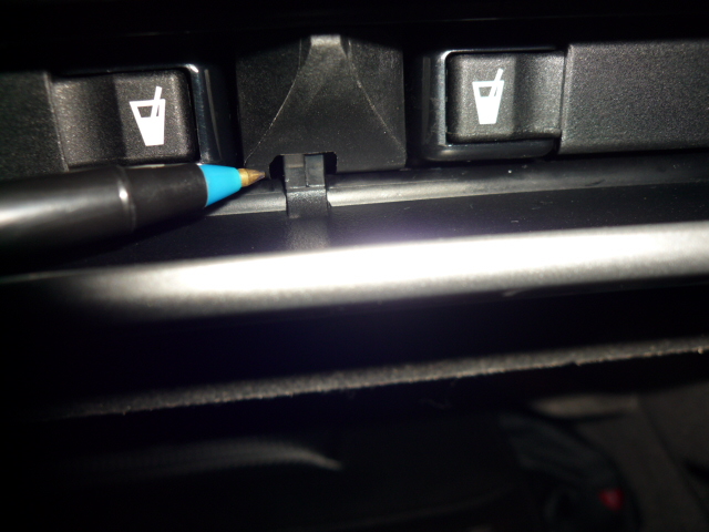

When trying to close it, does it hang open partially?
Old Nov 4, 2012 | 04:00 PM
Franky Knuckles's Avatar
Joined: May 2012
Posts: 73
From: ATL
Franky Knuckles is infamous around these parts
When trying to close it it hangs open all the way, basically like how it looks in the pic above. It doesn't seem to be catching onto to whatever it normally does.
Old Nov 4, 2012 | 04:12 PM
Steve997S's Avatar
Joined: Mar 2011
Posts: 1,075
From: San Antonio
Rep Power: 91
Steve997S has a reputation beyond reputeSteve997S has a reputation beyond reputeSteve997S has a reputation beyond reputeSteve997S has a reputation beyond reputeSteve997S has a reputation beyond reputeSteve997S has a reputation beyond reputeSteve997S has a reputation beyond reputeSteve997S has a reputation beyond reputeSteve997S has a reputation beyond reputeSteve997S has a reputation beyond reputeSteve997S has a reputation beyond repute
See pic. If the little tab pointed to by the blue pen has a horizontal hairline crack (near impossible to see just looking at it) it won't stay closed. Pen is pointing a little higher than where the crack usually develops. I tried every type glue to fix mine when it broke. Had to replace it in the end. But was under warranty.
