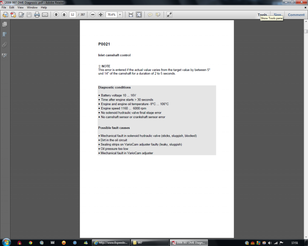

For your reference:

Johnnyb -- that is great man!, thank you so much for posting this...I'm very likely to print and show the dealer when they call if they haven't figured anything out.
