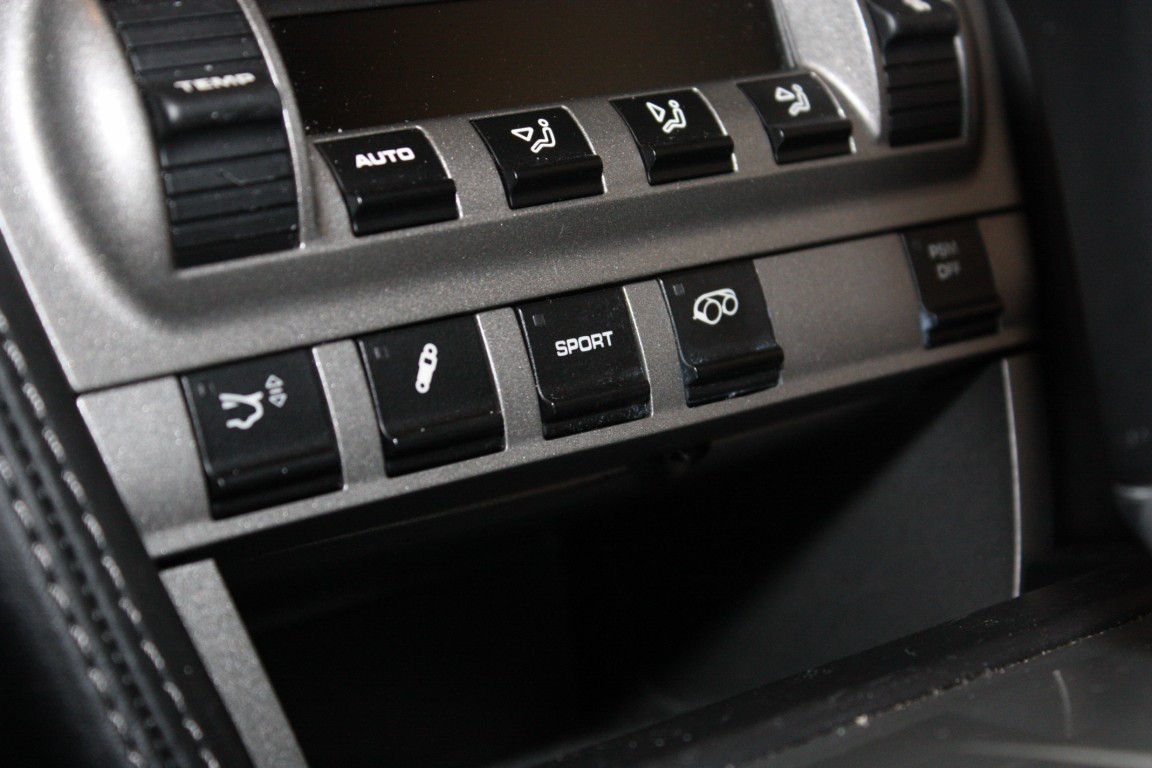

Update. After 3 weeks, I finally got my exhaust installed. The install took so long because of my specific requests from the dealer.
After reading all the PSE threads and after talking to the tech who worked on my car, I found out that the PSE installed retroactively does indeed go through the car's DME (computer) and restricts the opening of the exhaust to speed parameters.
With this in mind, I wanted my installation to enable me full control over the exhaust system outside of the DME. To do this, the tech installed a 997.2 lower console with the extra exhaust button, however, the exhaust button independently controls the exhaust. It is basically a button that gives power to the solenoids in the exhaust. No power, exhaust is loud, power, exhaust is quiet. Also, the switch recalls my latest setting when the car is turned off.
In terms of sound, it's perfect. The exhaust opened gives a nice aggressive note, especially as the engine revs past 3k. However, even when open, the exhaust is never droning, or tiring (I used to have an R32 with a full competition exhaust and it was annoying at highway speeds). Of course, when closed, the exhaust sounds completely stock.
Let me know if you have any specific questions about the exhaust. I love it!

Are you saying it took 3 weeks to install or 3 weeks of planning? If the install took 3 weeks I'd hate to see the bill.
I did the same on my 'ole' 997.1 regarding the console mounted 'exhaust logo' button. Mine always reverts to loud mode when I fire up the car.

Interesting that the button remembers your setting when you shut off the car. My car always starts in the off position.

Planning. Most of the time was spent waiting for a part to come in. Install took a day. I did not mind for the dealer to hang onto the car for the waiting period because they bailed me out in a panamera 4
