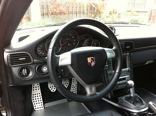

the triangle steering is the worst looking wheel ever...

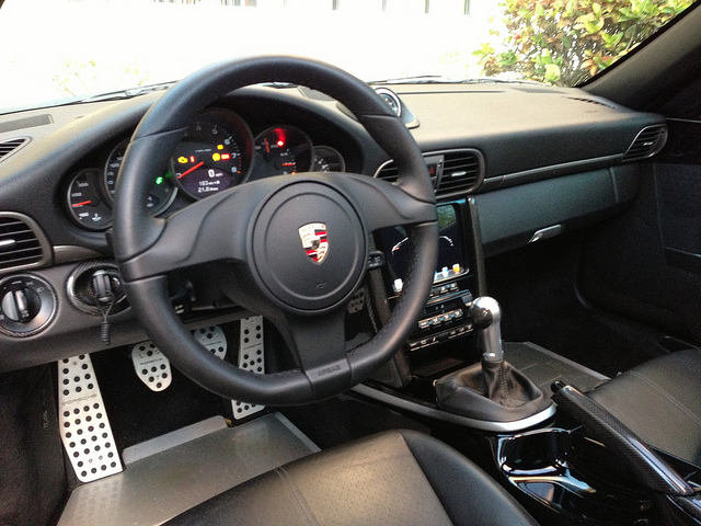

I went from this:
to this:
I went from this:
Very nice, what pedals are those? (if you don't mind me asking)

SICK looking interior.
What did you do to the PCM? Do you mind posting all the upgrades? Really love everything you did....

The pedals are from suncoast...
Old Feb 27, 2013 | 12:00 PM
JoelPirela's Avatar
Joined: Dec 2007
Posts: 1,749
From: Miami
Rep Power: 125
JoelPirela has a reputation beyond reputeJoelPirela has a reputation beyond reputeJoelPirela has a reputation beyond reputeJoelPirela has a reputation beyond reputeJoelPirela has a reputation beyond reputeJoelPirela has a reputation beyond reputeJoelPirela has a reputation beyond reputeJoelPirela has a reputation beyond reputeJoelPirela has a reputation beyond reputeJoelPirela has a reputation beyond reputeJoelPirela has a reputation beyond repute
Mine car is a 997.1.
I did:
Suncoast Pedals
Bumperplugs painted console/mirrors/door spears
Carbon fiber from DB carbon on doors, console lid, ignition, door pulls, side center dash and more
Rennline aluminum mats with 3M clear bra
2012 997.2 Steering wheel/airbag
2013 997.2 PSM/Sport switch panel
PCM deleted and using an iPad mini
Painted center dash by bumperplugs...
And some other stuff that you can't see... like the carbon fiber X51 airbox, GT3 TB, 84mm Plenum and 200 cell X pipe cats and muffler delete.
