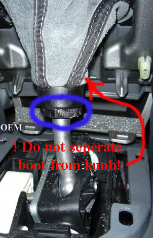

You don't need tools. A vice grip will likely damage the leather and plastic locking collar.
There is a plastic collar that locks the **** to the boot. The collar is hidden under the leather boot at the top where it connects to the ****. It is a hard plastic ring.
Grab the plastic collar and rotate the collar and boot clockwise. This unlocks the boot from the ****.
Then, grab the **** and pull up.
The reason the **** isn't coming up is it is locked to the boot. When the two are locked together, the **** won't pull upward.

32Krazy - i have tried to figure it out but the vice/pliers/pry method still doesnt make sense to me....
bbyu - thanks for the DIY but i had already twisted the locking ring clockwise and the **** just doesnt budge off the shifter.

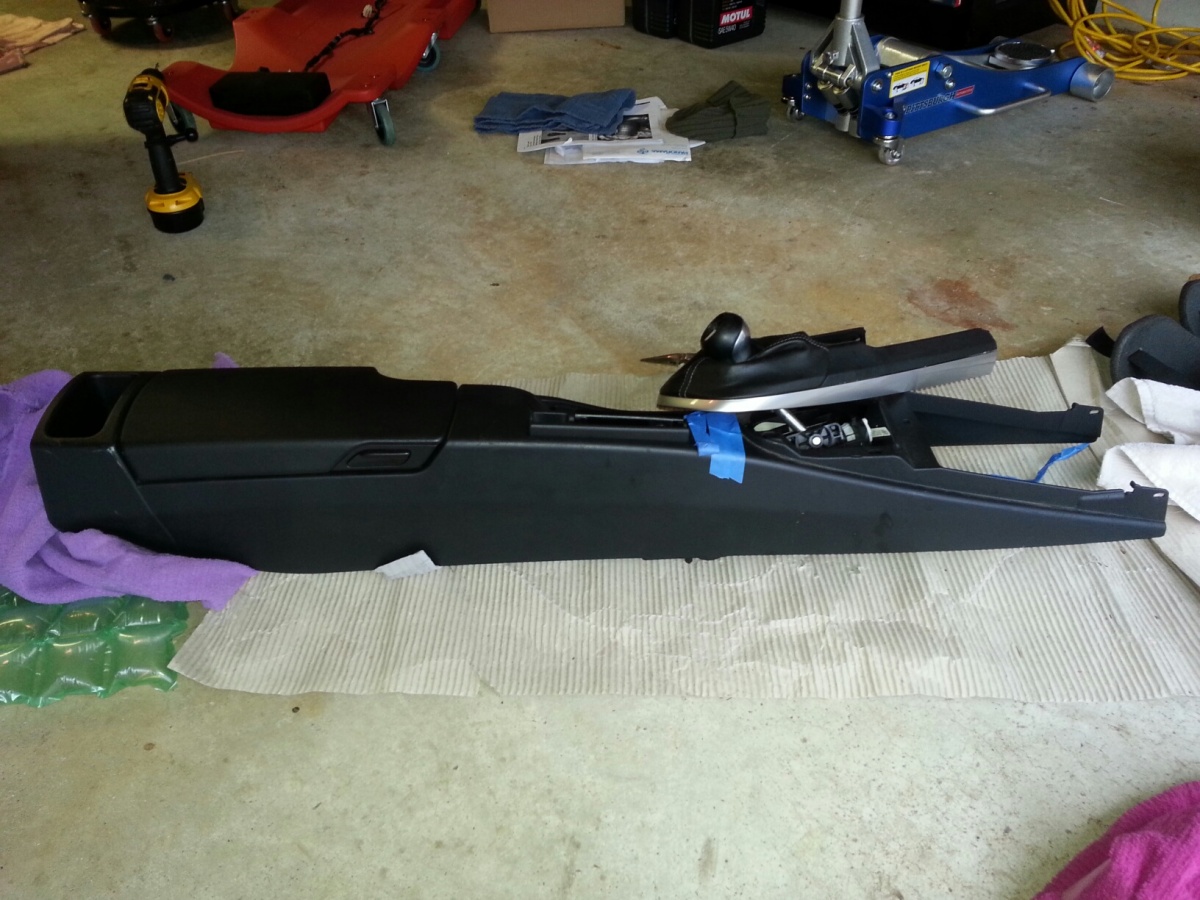

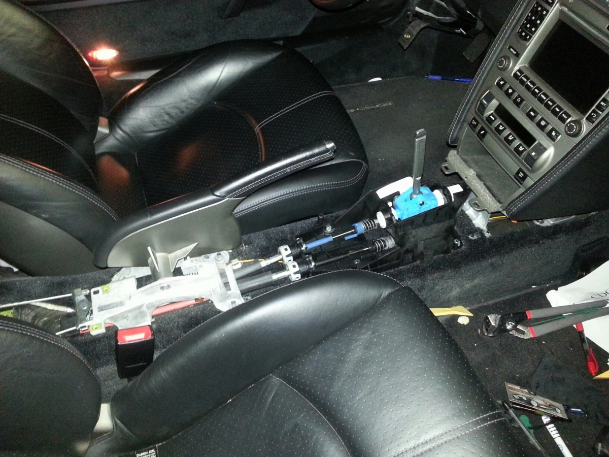

SO....here is where I am at....with a lot of swearing and twisting myself into a pretzel, I have removed the entire ****/boot, center console, AND gear shift housing completely out of the car as a single unit. The whole thing is now out of the car but still all attached to eachother. LOL
I am thinking i will just take this whole unit over to a porsche shop and see if they have any better luck than i have....story of my life...
At least the SSK is installed and feels great through the gears. Cant wait to drive it.
