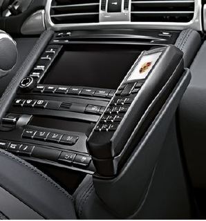

*) There is an option for a phone handset mounted in the car that is a traditional phone handset with speaker for the ear and mic, which connects via bluetooth to the PCM to act as the audio interface rather than the the cars speakers/mic. This, rather than the old corded connection, talks to the PCM via bluetooth. Useful to hand the phone to the passenger or backseat occupants for them to carry a conversation.
