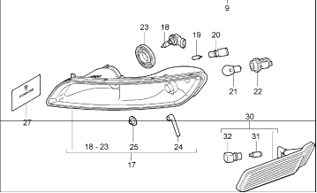

it looks like it might be part #18? listed as "halogen bulb", p/n 999.631.142.90. that looks like it is on the inside of the lamp. either way, just call a stealership, give them your VIN and tell them what you are looking for. they are pretty good about finding part numbers (so you can give to your indy etc).

I think it's either #18 or #21 but will confirm when I'm in front of the car

In that housing we have an H8 fog light bulb and a W5W city light bulb coupled with a 7507 turn signal bulb.

It's not the fog light, because I never turn those on. It's not the indicator (at least I don't think).
The photo I took is with the engine running and the lights on, so I'm guessing that would be the city light ?

check the turn signal to verify by turning on the hazard lamps, in the pic it looks amber where the city light would be more white.

It's not the turn signal bulb. Emergency lights work fine. It's the bulb closest to the middle of the car (I'm guessing that makes it #18 in the diagram?)
I agree the other one looks kind of orange. I'm guessing I should replace both.

18 looks to be the H8, 19 the W5W. The W5W could be out and the light bouncing off the 7507 reflecting yellow on the one thats working in your pic. Im afraid we dont offer OEM lighting but the W5W's should only run about $22 a pair at the dealer and we suggest replacing in pairs. We offer a whiter replacement at $20 per pair closer to the HID headlights in Kelvin grade.
I dont recall if the 997 non turbo uses a blue bulb, the 997 Turbo does as an oem part, if not you can buy any W5W at your local auto parts store for about $12 a pair.
