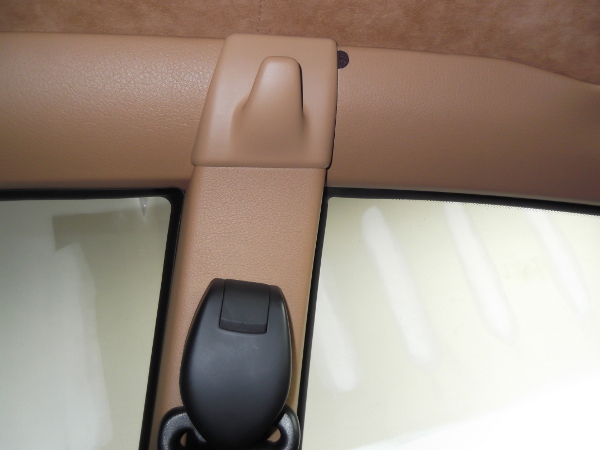

Would it be possible to have a picture of the exact location on where to put insulating material? I have the same annoying tick...tick...tick sound and would love to get rid of it. Surprisingly, it feel like the sound is coming from the driver door or window. Very difficult to locate.

Old Mar 26, 2013 | 03:08 PM
PSPorsche's Avatar
Joined: Oct 2011
Posts: 433
Rep Power: 59
PSPorsche has a reputation beyond reputePSPorsche has a reputation beyond reputePSPorsche has a reputation beyond reputePSPorsche has a reputation beyond reputePSPorsche has a reputation beyond reputePSPorsche has a reputation beyond reputePSPorsche has a reputation beyond reputePSPorsche has a reputation beyond reputePSPorsche has a reputation beyond reputePSPorsche has a reputation beyond reputePSPorsche has a reputation beyond repute
Originally Posted by yvesvidal
Would it be possible to have a picture of the exact location...
The little brown circle underneath the coat hook trim piece (top/center of this picture) is a round felt "sticky" I placed to test the solution. So far it has worked, and I'll put something "nicer" and unobtrusive there later.
(Note, this picture is of the passenger side of the vehicle).

I believe there's a way to remove the hook (just pull it up?) and, I imagine, line the contact surfaces with strips of adhesive felt in a way that would make it invisible. I am convinced that if one stuffs enough felt into these cars, they will be quiet and we can then enjoy the melodic sounds of our flat sixes!
