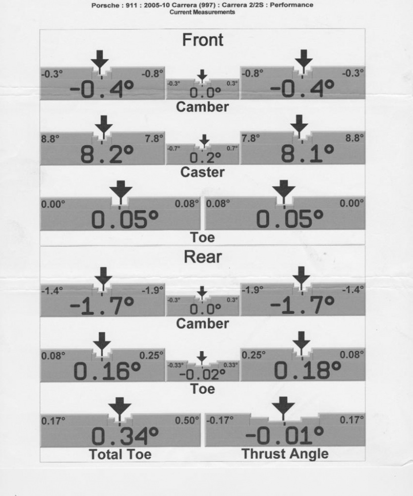

Hi All -
I just dropped my 997 C2 - using Cargraphic springs (Thanks to Mike at RSS). Question for everyone who's lowered on H&R's or Eibachs... After you got your car aligned, are the rear toe settings still way too "off" to get decent tire wear/life?
I'm debating whether to get the rear toe links now and just take the plunge, or whether if a good alignment can get me 90% of the way there.
Thoughts are appreciated!
Thanks,
John

Hi John,
Welcome to 6Speed and welcome to a fellow Socal P car owner.
My car is a 997.2 C2 with H&R springs. I have Michelin Super Sports and am very pleased with the tread wear and the camber and toe. Here is my set up.

Daberlin, thank you very much! This is really helpful!
Best,
John
