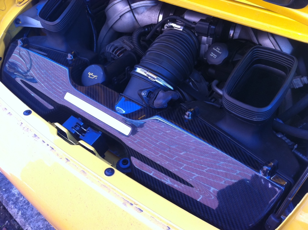

Hi there
Tonight I fitted:-
Carbon fiber plenum
GT3 throttle body (76mm upto 82mm)
X51 carbon fiber dual air intake
Installation was a bit tight but easier than expected, took my time to prevent any potential air/vacuum links. Made sure to disconnect battery etc. So ECU fully reset.
Connected back up, left for 30s so throttle body could sort itself out, started car and no idle issues, left it to idle for 5 minutes.
Went for a drive, throttle seems a little less responsive which is to be expected as at present air box has a pair of old stock paper filters in it and the right hand side intake does not have a hold cut yet in the decklid for cold air feed. Felt similar to the stock filter in the regular Airbox would do, as high flow panel filters really improve throttle response.
So jobs to do:-
1. Cut hole in deck lid so cold air feed works.
2. Fit performance BMC filters, due end of week.
3. Extend MAF wiring so can route maf cable neatly under Airbox and not over it.
4. Maybe buy shorter oil filler tube, as stock one is too long, but does fit.
5. Fit new plugs, current are 20k miles old.
6. Change oil to Millers Nano oil.
7. Go back to dyno.
A picture of course:-
Glad I did it myself, always more enjoyable, though only when it goes well.
Oh and finally the good point, no infact the sensational point, the noise OMG the noise, no word of a lie past 5000RPM it sounds like 10000RPM, sounds like a CUP car, I'd go as far as saying the noise in the cabin is GT3 beating. Seems to pull better too, but sure improve more with second hole cut along with fresh performance filters.

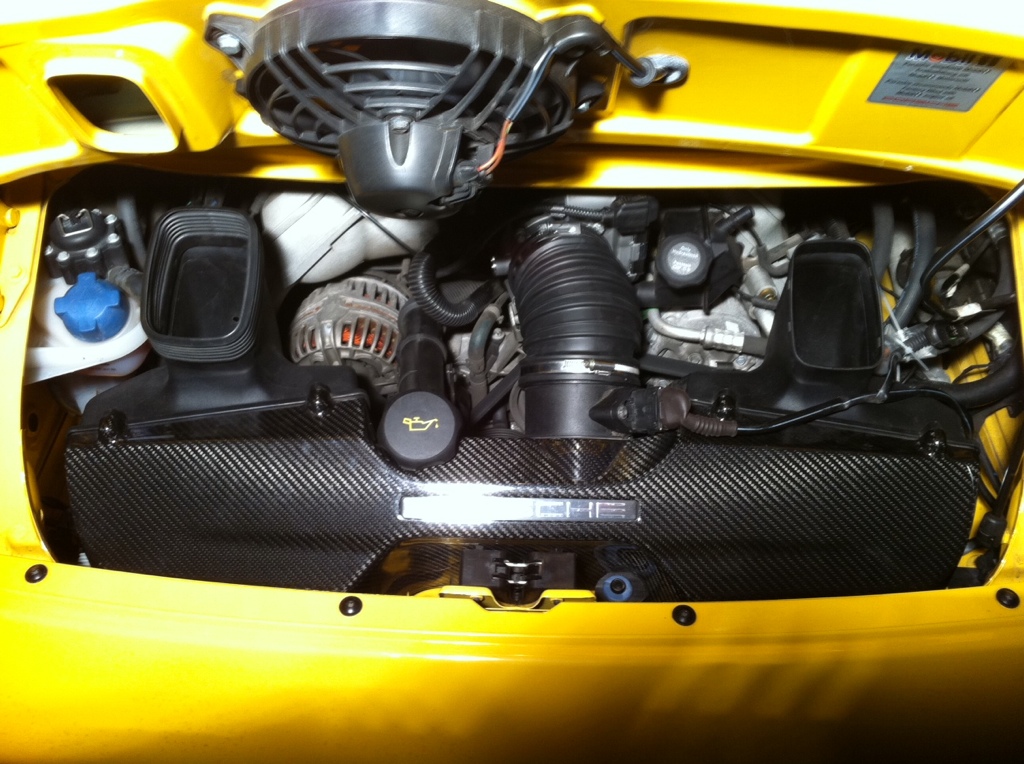

Second hole now cut by local garage.

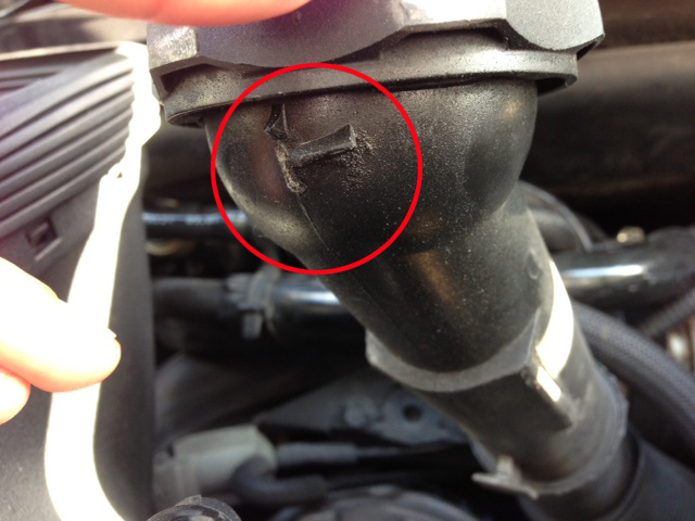

Couple of questions m8:-
1. Can you post of picture of your oil filler neck pushed back and located please so I can see how far is safe to push it as I am scared of it breaking.
2. Did you have to calibrate the larger throttle body or anything, or did you just disconnect battery, fit it all, re-connect and just start the car and leave to idle?

The tube is actually pretty bendable... I had to trim the little hook and the bottom of the pouring part in order to correctly latch with the X51 box
To calibrate the TB, disconnect the battery prior to taking the original TB out. Install new TB, connect the battery and switch to ignition without starting the car. wait 30 seconds, switch off, and now start the car. The TB will adjust to maximum opening and maximum closing during this procedure. If you don't do it, the accelerator pedal input may not reflect the true TB flap's position.

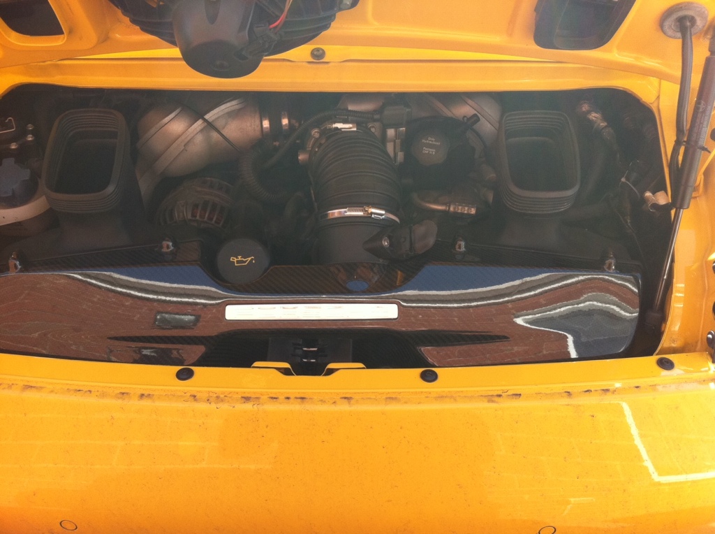

Hi there
Ok got BMC filters in, allowed throttle body to adjust and went for a good drive, I'd say what I've noticed is:-
Throttle response is now better than the stock paper filters, but marginally less slight than before stock BMC airbox and stock throttlebody, this is no doubt the effect going from 76mm - 82mm throttle body, is it an issue, well no, it's marginal and hard to notice.
Maybe a marginal torque loss sub 3000rpm but it could just be the fact the car seems smoother in power delivery now, as the car seems to accelerate faster.
4000rpm and above the car pulls harder, but at 5500rpm and above it feels like it's pulling way harder and would keep pulling so hard right upto 9000rpm if the engine could spin that fast. Put it this way floor it in 2nd gear at 4000rpm and you need to be very quick to get the change upto 3rd.
It seems 1-2mph quicker by a landmark I regular accelerate too on my route to work. If I was to have the dyno in my head I'd be thinking similar/same power upto 3500rpm but then a steeping upwards curve above 3500rpm with more top-end power for sure.
Onto the noise, sorry GT3 guys but from inside the cabin to my ears it's better, from the outside I'd say it's not, but on the inside it's like a race/cup car when the revs pass 5000rpm, infact 5000rpm now sounds like 7000rpm did previously, it's absolute music to my ears.
Shall aim to get on dyno next week and to see if there is any change power/torque.
P.S. Still need to sort rubber bellow on right side to seal against warm air but the gap is less than an inch so doubt it's having a noticeable effect on performance.

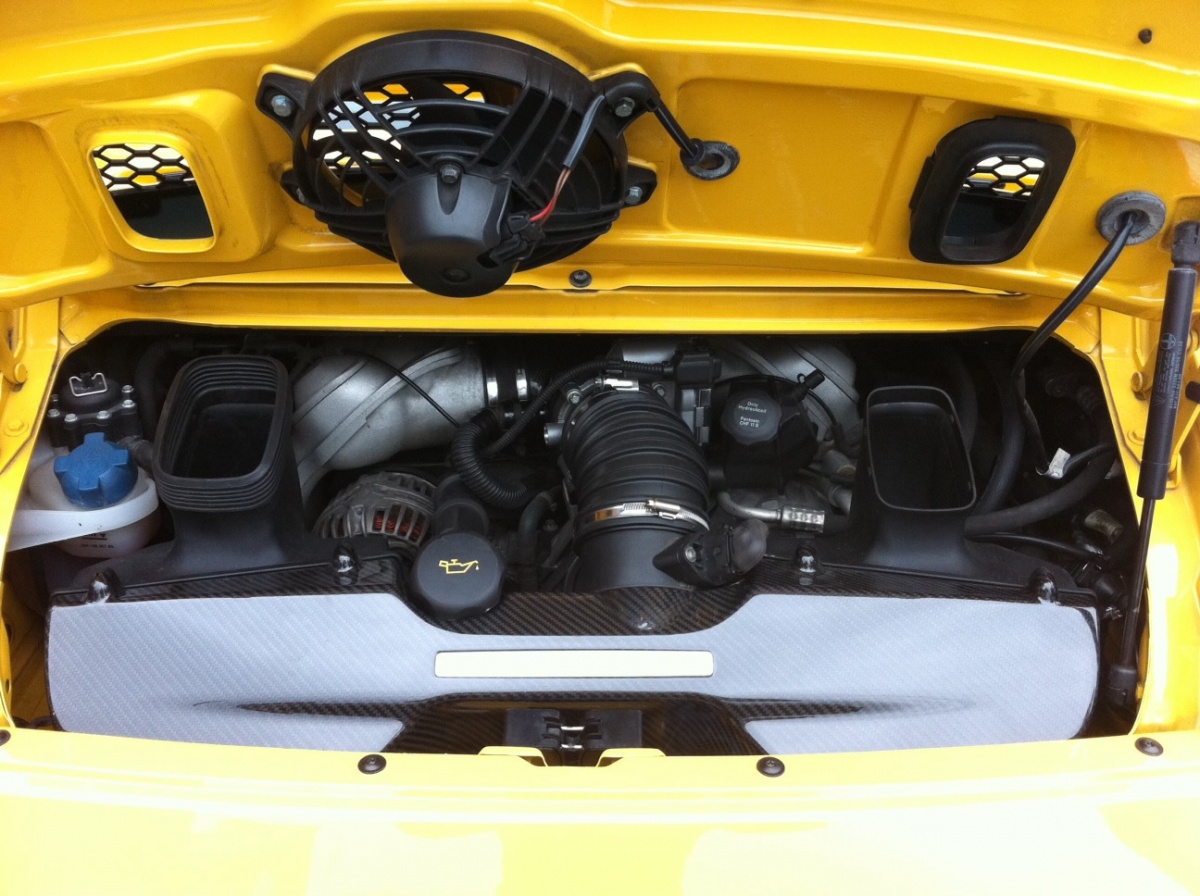

Dremel the bellow of my old Airbox and it fits perfectly over the X51 snorkel, so now it's only getting cold air. Noise and power vastly improved, get to dyno next weekend.
Looks almost OEM
Car is in need of a good clean now!
