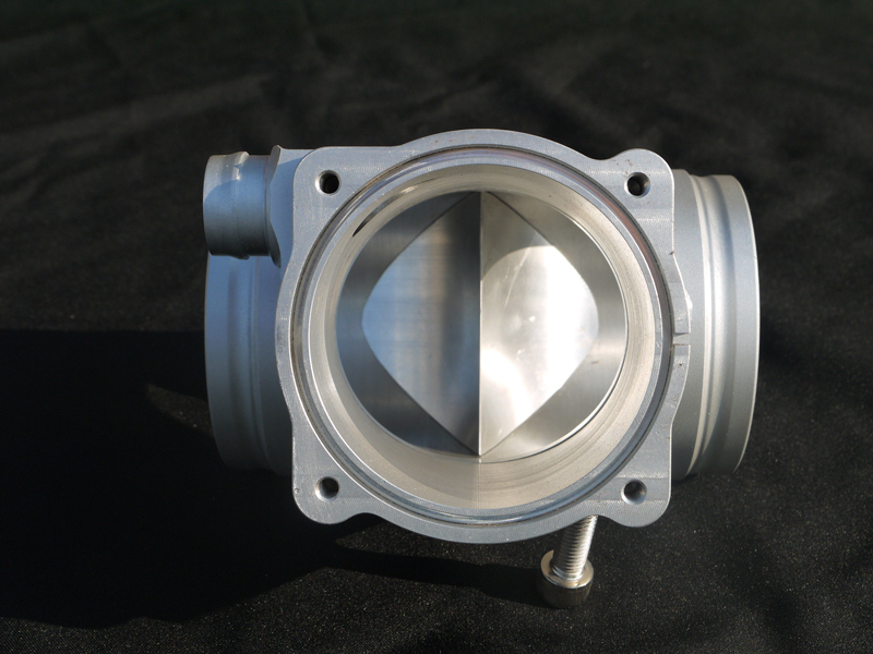

Does your plenum has this shape inside?
Nope same as stock inside. That design you posted could maybe help improve air velocity which could help with low-end torque/response. Is that the NHP one?
