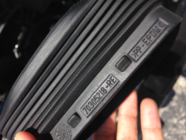

Hi there
Got an X51 airbox as you guys know, but its missing a part which Porsche can't locate for me as they need a partcode, I've circled the image in the part:-
Can someone please pull this part of their airbox, it just easily pulls off and should have a partcode stamped on it. Can someone post the partcodes which are stamped on it please to help me source a part.
If Porsche don't have it separately then I need to try and get something made up, otherwise my engine will suck in warm air.

Hi!
That part is not on the PET catalog. I pull mine off and this is what i found:
it's not a 997.XXX.XXX.XX part...

Originally Posted by JoelPirela
Hi!
Hi Joel
Do you think anyone can supply me this part?
One more thing the one of the other side is a slightly different size, is this true?

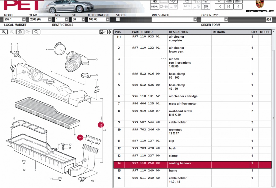

This schematic of the regular airbox doesn't show that as a seperate part #

yes, left and right are different sizes... the driver's side is bigger
