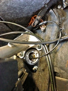

There are main grounding points in the rear near the upper shock mounts. Suggest checking connections at these locations. This is photo of one of them in the rear of my cab. Note the brown ground wires connected under the ground nut.
