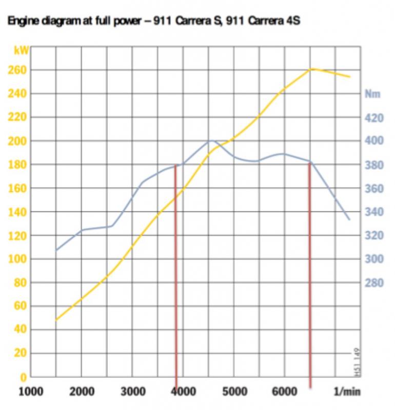

So I find this an interesting academic question, so I'll take a stab at it. I believe you want to maximize the area under the torque curve.
Case 1: Looking at my car (997.1S) the curve starts to drop off abruptly at 6500 rpm. The ratio between 1st and 2nd is 2.32/3.91 = 0.593. So if shifted at 6500, the rpms would drop to 3857. The two rpm lines are shown (approx) in red below.

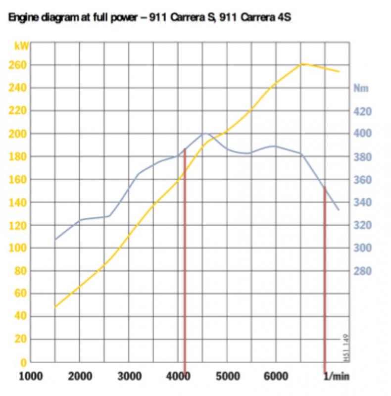

Case 2: Let's say you shift at 7000 rpm. Then that's a drop to 4153 rpm. Shown below:
So it looks like shifting at 7000rpm+ gives a slightly larger area under the curve. I think if I had the actual graph in excel I could figure it out exactly. But this is power point engineering and I'm a robot guy, so someone else please chime in if my logic is flawed.

Edit... I think something is wrong with my rpm drops. I'll look at it tomorrow.
