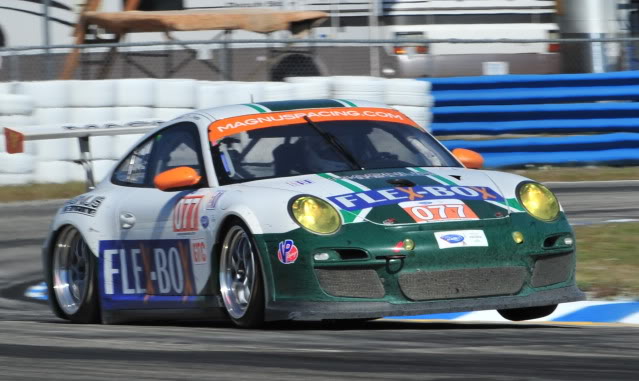

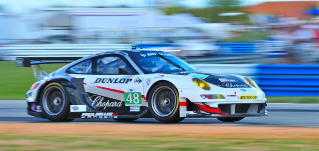

When you say "light", do you mean like this:
Or this?
I'm joking. If you want to experience "light", try a C5 Corvette.

Oh, and nikon - those pics are exactly it. Just a little bit more exaggerated than we experience on the street!
LOL. Those are courtesy of turn #5 at Sebring.
